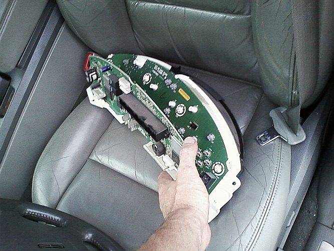

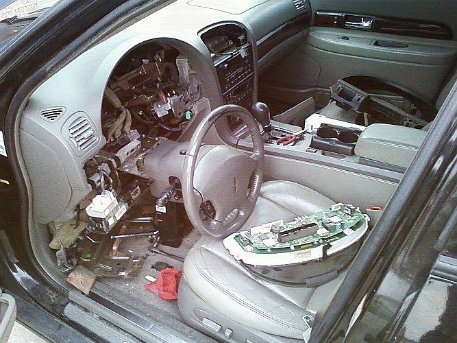

This really isn't such a bad R&R, but after a couple months of listening to the 25 beeps every time I start the car because of the burnt out SRS light,I finally had some time to tear into the dash to replace the bulb.

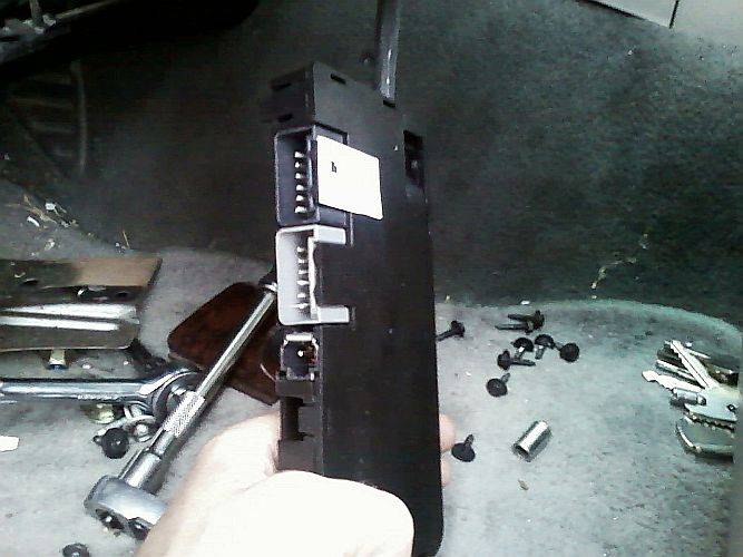

Now the SRS light had been on since I bought the car. The owner showed me the receipt showing that a new clock spring had been put in by some shop a couple weeks before I bought it. I have checked the usual areas for the fault like under seat for the broken wire and all has been good. So I have been stumped and obviously haven't bothered with it.
Well, when pulling the dash apart I saw that there is a module under the steering column that has "clockspring" printed on it. There are 3 plugs that go to this thing and the smallest plug was not connected to it. I won't get the LS put back together until later today but have high hopes and trust that this disconnection has been the fault. The module is in the 3rd pic.

Take that bitch apart!!!! How hard was it to take the gauge cluster out? I will probably be taking the mine out to do a little work on it this summer

It's not really that bad. To get to where I am in the pic didn't take more than about 30 minutes or so. What are you going to do to your cluster?

Well, I got the bulb replaced so at least the car isn't beeping at me all of the time, but that plug that was disconnected wasn't the fault....dang-it. :mad:

Sweet thanks. Thats not bad at all. I will try to put one of those little valentine radars in there, the stealth units, try to find a good spot were it doesn't interfere with anything else.
It's good to hear you got one of the problems out of the way. What's the next step?
I'm not sure now, I really do not know where to look exactly. I've read lots of Air bag light threads but other than the areas we know to look I'm stumped. Might just take it in............or put a piece of black tape over the light. :p
