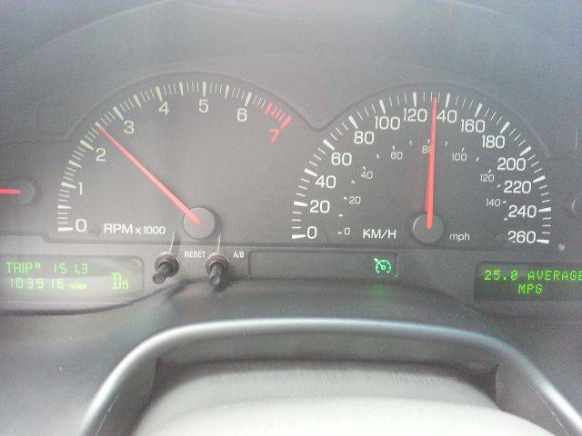

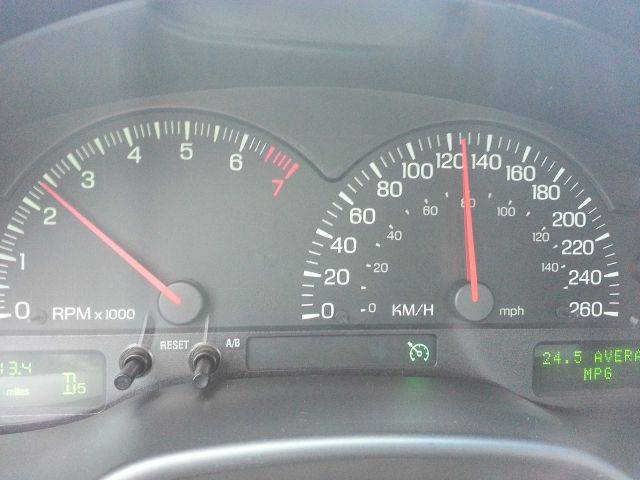

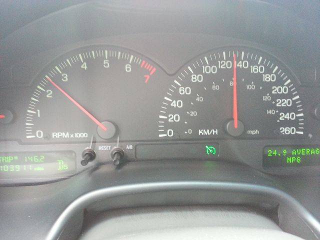

I usually get about 14/15 mpg on my 2000 with 20" wheels
Had a little 3hr round trip to the border and back the other day.
good chance to reset it on a 3/4 tank of fuel.
let it settle and these were the results.
If I want the 27Mpg, I've had in the past, I need to be doing just under 2000RPM at 60Mph and that's just not going to happen very often.
