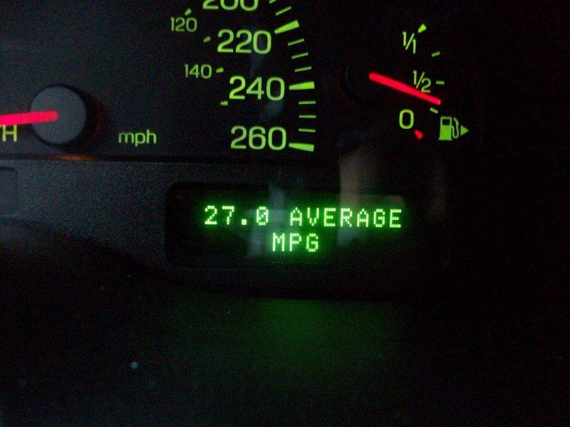

          On the Queensway from Bank street, all the way out to the sticks West,
          after I had my new exhaust added, the LS can do this at 2200RPM on cruise.
          (no traffic)
          If the fuel filter is old and clogged how would it get more fuel through in order to produce 11.8mpg ?

          Driving on the highway from Ottawa to Toronto, I was also getting 27mpg. But city driving I'm lucky to get 11-12mpg.
          LOL definitely not. I use hand break when I park so I always disengage before leaving.

          Next time I'm out and about the city, I'll switch my read-out to mpg and have a look, see where it's at these days.
          I only get good results like that when I'm on the highway with the cruise on driving like a grandpa.
