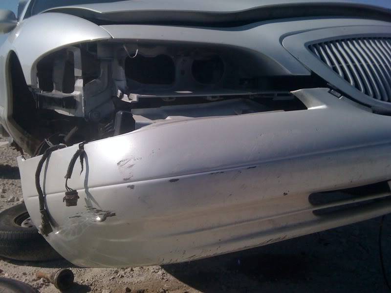

Another one bites the dust :-( ,this make me very sad
