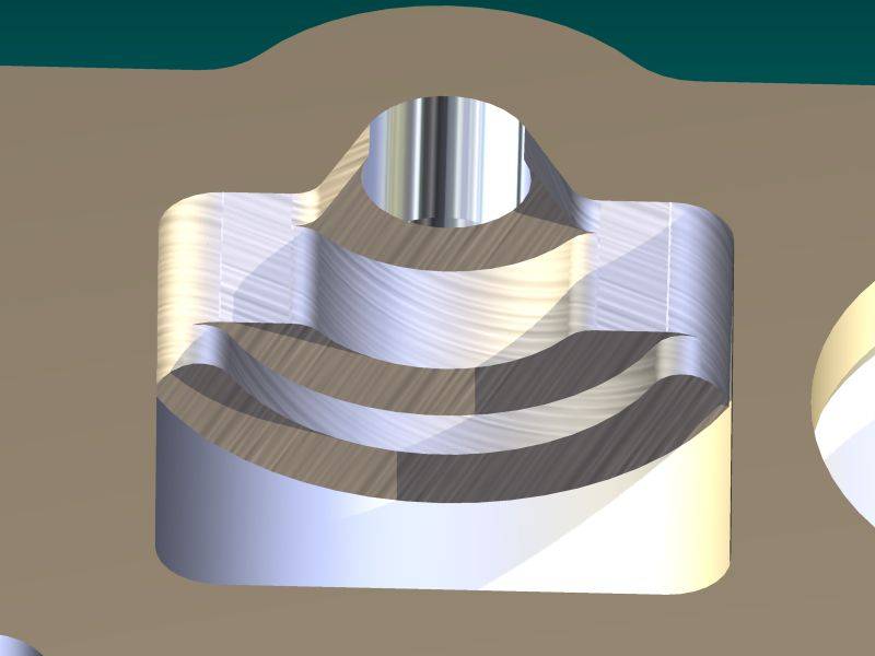

As far as the oval port bosses are concerned, Idon't see why you can't go in from the side and angle the nozzle down to the port. I would think there is plenty of material there to hold nitrous nozzles in place.
I'm also trying to keep machining ease/costs in mind. The wilder I get with the design, the more costs go up. There is also the fact that I started this design for me and maybe a few others. I just don't have the funds to buy all the material and pay a machine shop for a run of 5 or MORE.
I am MORE than willing to work with some investors on this because I think that there are ALOT of B-head powered Fords out there thatwould take notice.

The clearance problems at the hood are focused around the front end of the SC (pulley diameters). If I remember correctly on Gen ll the hood issue was resolved by lowering the cross member 1.25" or so. The Gen 1 hood was even more of a problem. I wish you well on your project, it should be popular.
actually i have plenty of clearance at the pulley, but i had to cut into the cowl to get the air intake to fit. There is no way i would shim the k member 1.25".

I personally would like to see some ribbing around the outside perimeter to dress it up a bit.
I think he wants to use 6061 and mill them out of solid.
I have acess to a Funac Robodrill if machining becomes a roadblock and can edit code if a problem pops up.
The nice thing about 6061 is if a problem pops up "and one will" you can weld it up and not lose the work you have into it.
I am willing to help anyway I can.

I am going to take my CAD files to a couple of machine shops tomorrow and see what they would charge me to do a prototype to install on my VIII and iron out all the kinks. I still have NO idea how the alternator is gonna fit into this equation (I.E. Keep it in the same location vs Relocate it like the K/B C-Head kits) let ALONE how much I will have to modify the top plate and S/C snout to make the pulleys line up. I'll probably have a PRE-Prototype milled out of a chunk of ABS plastic to save on mock up costs and go from there. As soon as I get back on my feet from being unemployed which should'nt take long, I'll get an M112 purchased and start fabbing.
Keep in mind guys............This is NOT going to be a drop-in/crank up kit. You are going to have to purchase and fab aftermarket fuel rails, do an 8 rib conversion (junkyards are your best friend), trans work for you automatic lovers out there, and MAF/Intake modifications.
I am going to try my hardest to keep the unit as LOW on the engine as possible. I'm not going to make any promises, but I'm hoping to have a lower cross-section than a 96-98 Cobra intake. This means that you SHOULD be able to stuff it under a GEN2 with NO hood issues, and us GEN1 guys........Well I don't know,(the snout/pulley has me worried.)
When I started this project I had no desire to make more than 2 or 3 units but if the interest is there, I'll see what I can do. If you know of any cobra owners that would be interested point them to this thread.

Just remember HEAT is your enemy with these SC's. They really hurt performance if the charge gets too warm. Don't get too skinny to hurt yourself, leave room for a water cooled IC.
I'm not even considering an IC system right now. I planned on running methanol injection from the start. My goal is to be able to have a STOCKish hoodline and leave it at that.
There is just so LITTLE room with the B-heads that the machining required to cram something in there would make it cost prohibitive. You could switch to C-heads and go with a K/B kit instead.
Meth will more than enough to cool the intake charge.
