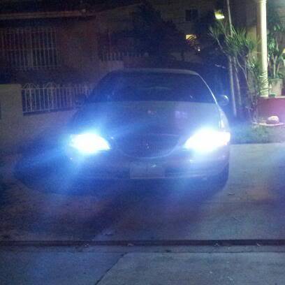

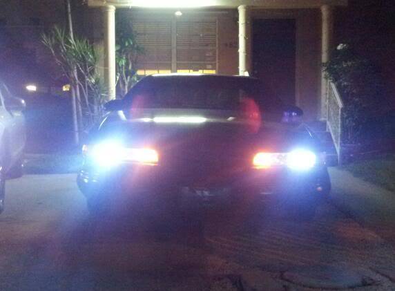

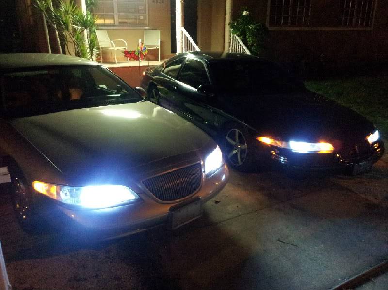

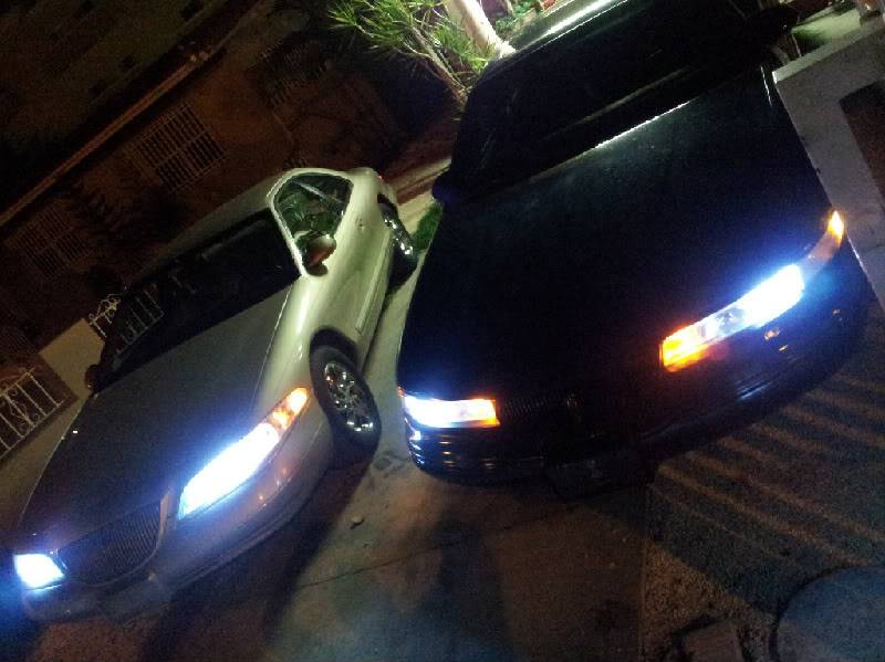

Ok guys just as the title says, i just installed aftermarket HID's on both my Marks. I took a couple pictures after the install however i don't think the below mentioned issue is noticeable. On my black 93, the driver's side light is a tad weaker than the passenger side. I can notice it but i recognize that Im very picky. Maybe Im being too anal. Below you will see a couple pics however remember, its harder to notice in pictures. Check 'em out.

They are indeed a bit brighter. They are a bit more blue as well but that's because i went with 8000k lights. I love the way they look. Very crisp, clear view. I don't get any message on my 97. It works just as well as the stock HID's.

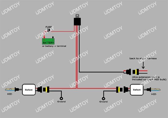

Alex did you buy a relayed harness for the '93? That should help them out. I bought 2 relayed harnesses since I am running dual HID's, and they have never missed a beat and are super strong

I may go ahead and get the relay harness after all, is it hard to wire into an already installed setup?

Gen 2's don't need a relay harness, but I wouldn't install HID's in a Gen 1 without one.
Including a 96?
If the answer is yes, I'm ordering the relay harness from VVME tonight. Are they hard to install into an already existing HID installation?
Including a 96?
Unless the car was originally equipped with factory HID's, then it needs the relay harness.
