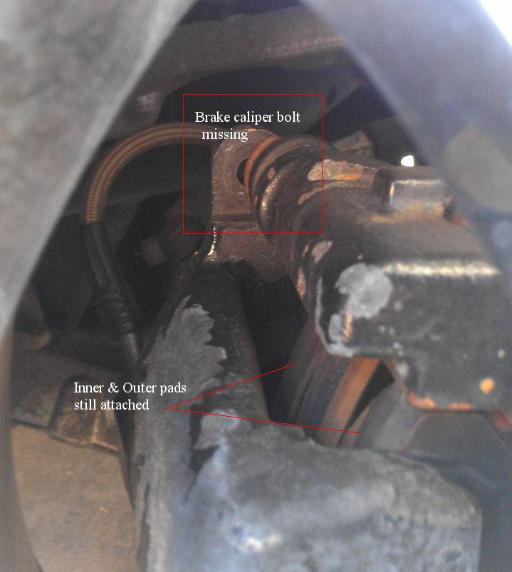

i spotted this on my drivers side rear wheel when i was putting air in it earlier, looks like something isnt connected when i compared it to the passenger side, never noticed this before, i've never messed with the brakes on my car so dont know much about them, any help on this would be much appreciated
drivers side
passenger side
Your missing the caliper bolt. Do not drive the car until it is replaced or repaired as you could lose your brakes.
Holy s*it. Those lines also don't look stock.
+1 on Brake caliper bolt (2 required) tightens to 26 lb-ft.
or, brake caliper anchor plate bolts.

I would take that apart and see what else got/is damaged or missing.
You might be in for more then just the bolts.
Pads and rotor are most likely worn uneven and I would suspect entire complete replacement.
I don't even see the inside pad in that photo.

looks like someone was in there and hand tightened it all back together.
appreciate the help, scary part is i have no idea how long its been like that, doesnt make any funny noise or anything, car stops the same as it always has
Man I must be getting old I can't see anything you guys are saying is missing. Also in one pic I can see its the outboard pad you see?
Yup, I see the inner pad now.

Looks like the way the caliper is sitting, the bottom bolt is holding it in place.

That's actually the inside edge of the rotor. Rears are still vented. The inner pad is likely still there unless it broke apart from misalignment, you just cant see it from this angle/lighting. Still, scary! Makes you question if the others are properly tightened. Hopefully the slide bolt is not snapped off in the caliper bracket. In addition to new pads and rotor(s) (for both sides if the brakes are not new within the last 6 months or so) you may need a new bracket.

the pads would still be held in by the caliper mount bracket... not the caliper itself
Correct, the pad's backing at minimum will still be in there. The abrasive might not be. THe outer pad will make up for that lmao!
LOL Only 1 picture was coming up when looking at this thread. It popped up 2 pics today and can see missing bolt now.
well i got the chance to get in there today and see the totality of the problem. the caliber bolt sheared off, bottom half was still inside the guide pin. took everything apart including the bracket, brake pads, and rotor, good news is everything still looked almost new for some reason. brakes pads were evenly worn, rotors had no indents or odd wear on the back or front. so put a new guide pin and caliber bolt in and assembled everything, good as new now, i actually noticed a slight improvement in the braking, better than i've ever experienced on the car and i've had it for over 2 years. thanks for all your help
