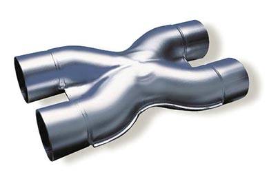

I am going to install a 2.5 pipe true dual exhaust system from the manifolds with two magnaflows. Do i have to install an x-pipe or can I just run two pipes back? What are the pros?
x pipe, dual x pipe, h pipe, y pipe, dual in dual out muffler, do something or won't flow well and sound terrible.
If you don't cross the system somehow, it will sound very flappy. Sounds like A$$ without it...not "essential", but very well worth the money

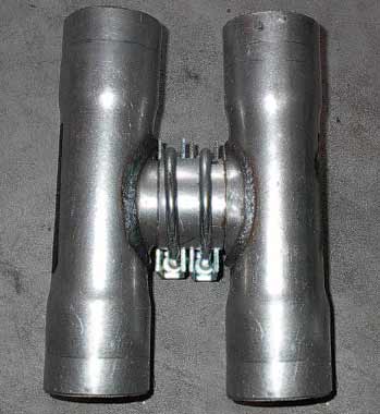

Definitely get a H or Xpipe. I ran my car with no crossover for about a month and it sounded like some kind of hillbilly hayhauler pickup truck.
I recommend an X over an H, for tone purposes, an X gives a more deep sound while the H sounds kinda raspy. Double X is a bit much IMO, but it'll make it a tad quieter

You got that backwards Sapper. H is deeper, X is raspier.
Yup i have had both and prefer the h-pipe sound but the x pipe seems to flow a bit better.
:)Yep. Gotta agree with that. My '97 LSC with H-pipe and cherry bombs definitely has a deep rumble. Sounds like a classic 60's musclecar. I love it!!! But yeah, you have to cross the system or you'll get a harsh, "blatty" sound that would probably sound nasty.
Old 93 had stock lsc exhaust system I installed a xpipe with flowbastards
And my current 98 has a hpipe installed much prefer the sound of the h over x any day
