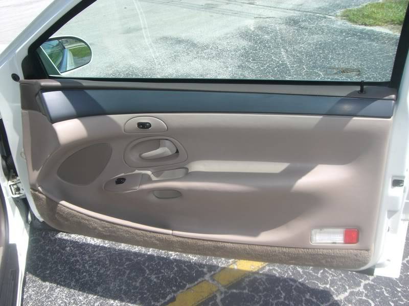

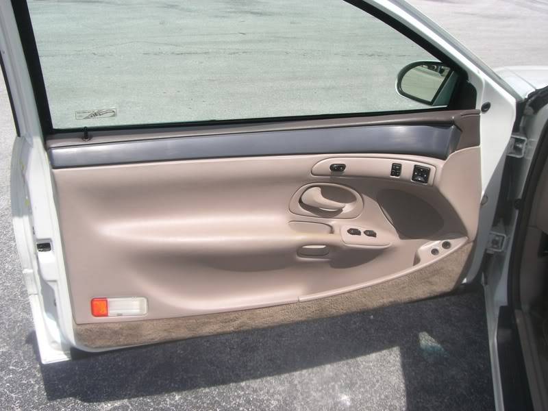

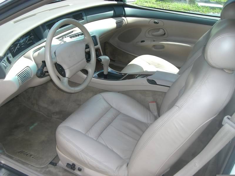

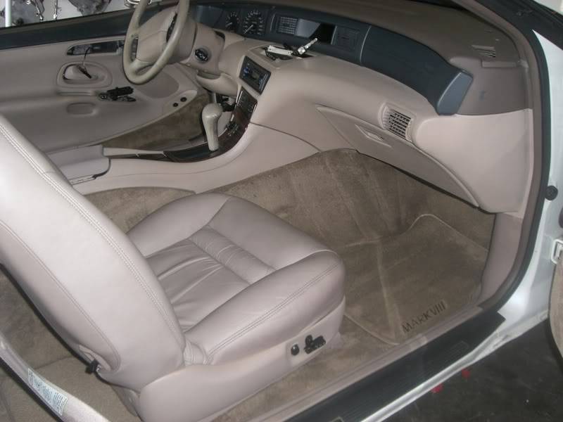

actually terry is incorrect, those pieces were originally tan like the rest of the interior, not black. i will tell you right now that someone painted them textured so mask the peeling tan ruberized coating, i normally take the coating off and buff the pieces because the natural finish under the ruber crap is the same color. if your pieces were factory wood you would be able to see the wood around the edges on the bottom side of the lids. your best bet if you like the wood look is to keep an eye on ebay, or find another mark VIII with saddle interior like yours and get the pieces that match the ones that are painted in your car. these are pics of a 93 that i removed all the rubber coating off all the interior trim pieces and restore the natural color of them.
this took me about a week! i also took out the seats, washed and conditioned them, cleaned the entire interior and shampoo'ed the rug. this was for a customer.
this was a 93 with only 43k miles and i added the wood grain stuff from a 94, this is a 93 so it did not come with the wood, it was all tan like the rest of the interior

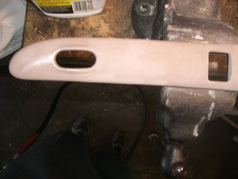

I've removed the rubber coating on most of my pieces now - used oven cleaner. Some pieces I have polished up and others I'm gonna paint with my Krylon paint for plastic.
