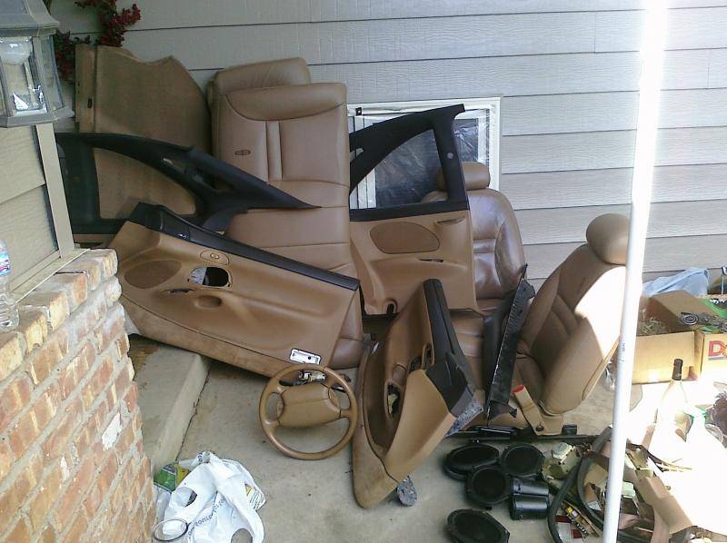

Yesterday I filled up my truck with parts from a BoB 95 LSC, mostly interior: seats, sail panels, console, under dash and kick panels. The plan is to swap out the ivory interior in one of my 96's. Tonight I realized the donor car was a 94- lots of parts have a production date around 9/93 (eatc, vrcm, seat motors, inst cluster)
The seller may also have the steering wheel and dash (front and rear) at his shop. He'll find out next week.
I'm trying to figure out which interior parts from the 94 will and won't fit in my 96.

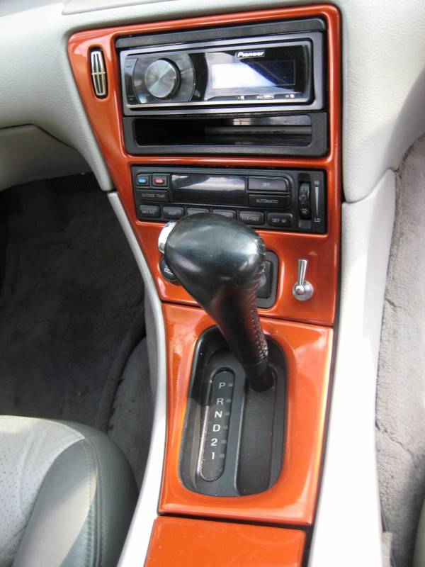

the first difference I notice is stereo HU and eatc beezle: the donor beezle is black (94 LSC) and single din. Single din is no prob and I think the 94 has trac control. Will that 94 beezle fit and bolt on the 96?

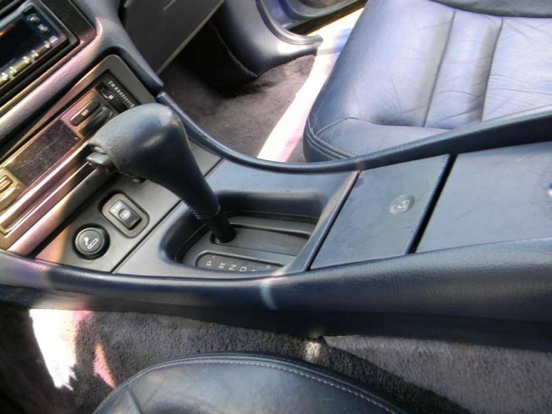

will the center console (with the armrest, cupholder, ashtray, shifter surround) fit onto my 96?

So wait you're saying you pulled the interior out of a 1st gen BOB LSC? Yet the interior parts were all from a 94? Did the car have any other LSC only parts to distinguish it as one? Those black seats you posted in another thread with the rip in the leather are base mark viii seats since they aren't perforated. Also fyi there is no such thing as a 94 LSC..95 was the first year. The reason the radio and eatc bezel look different is because the 93/94s used a single din radio opposed to the 95/96 double din radio. All 93/94 parts should interchange with the exception of the dash being different and possible the center console where it mates up to the dash.
The first difference I notice is stereo HU and eatc bezel: the donor bezel is black (94 LSC) and single din. Single din is no prob and I think the 94 has trac control. Will that 94 bezel fit and bolt on the 96?
You have to use a 95/96 dash with a 95/96 center councel and radio bezel
will the center console (with the armrest, cup holder, ashtray, shifter surround) fit onto my 96?
If it is from a 94 no.

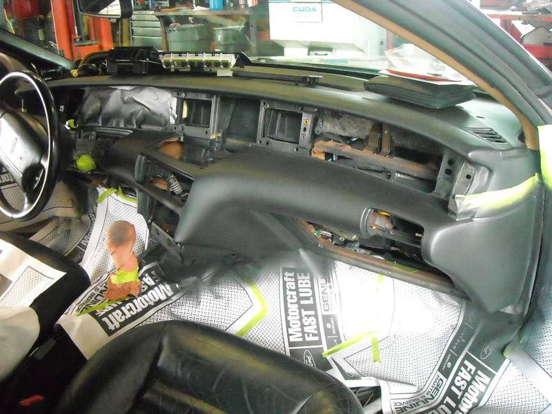

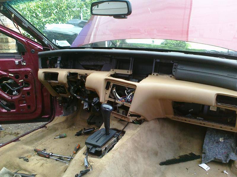

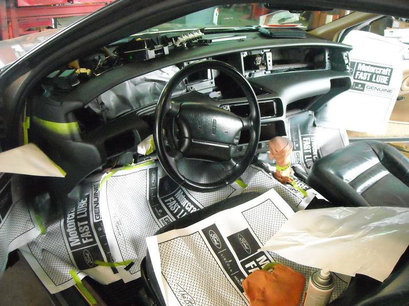

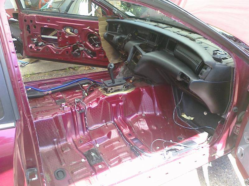

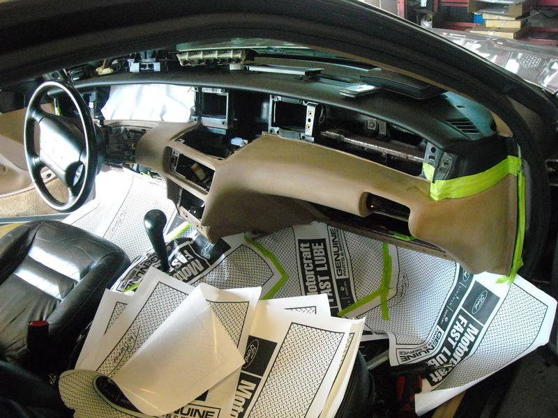

pretty sure he went to gen 2 interior Spree; thanks for all the helpful photos Eric
Spree, weren't you thinking about getting black int pieces?
ultimately I'm just gonna tear into it and see what I got, then what I need...some stuff will get painted probably
I thought I found a good dash in SC, and maybe I did- the vendor told me it's been sitting in the car outside for 40 months, he can't say what condition it is in. I did find gray carpet from a 95 locally
thanks DD, that def seems like an easier way to get a color change on the dash; Krylon Fusion paint eh?

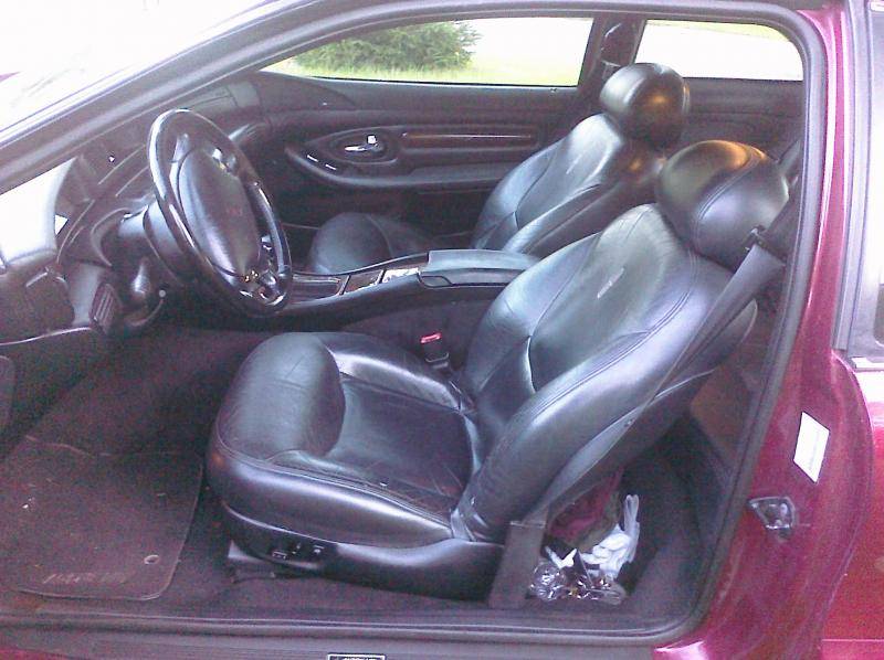

I have a black console boxed up in the garage. :) I don't plan to use it either. I need to make sure that it has a lid or not and if it does, it seems like the spring action didn't work. It shuts and opens fine but IIRC, it just stays down but really, how often are you digging in there? I don't think the lid is still with it.
Don't have an extra black shifter handle with a black button do you?
Terry, you sold me a black lid a few years back... wonder if its from that console.
No Dan, this one has the lid on it and it's in excellent condition around the edges. The button on it needs to be replaced and the lid doesn't have the spring action either. The box is full of those peanuts so, I'm trying not to take it out completely but the lid is there. I paid $70 for it and $20 shipping and never put in because it wasn't going to look right with what I done to my interior. It came out of a black on black 96 LSC that a member here had.
