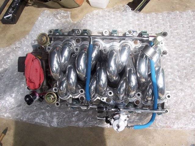

Driller had one cut apart and polished, he would be the one to ask if it was worth it... as far as actual extrude honing not that I know of...
I saw a definite increase in mid to upper rpms with the polished intake. Basically, the plenum was cut apart, the inlet tubes were radiused at the plenum and the entire intake was polished inside and out. The ports were then gasket matched (which really did not require very much). Paired with the headers it was a definite boost in HP levels.
That rocks! What did it cost to do the porting and polishing?Anybody know wall thickness on the tubes?
