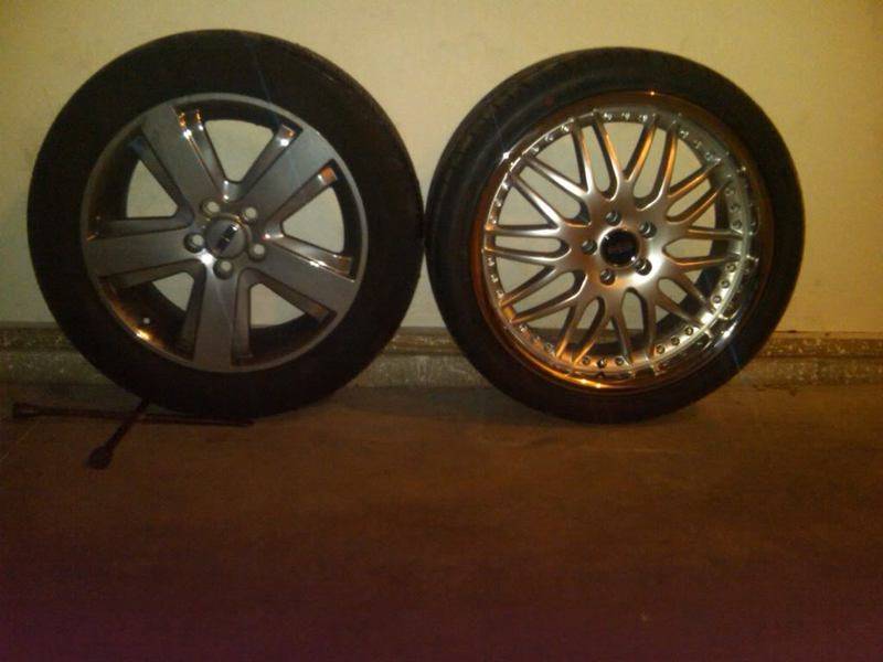

Here's a shot of the factory wheel and new wheel side-by-side. You can see the Hankook is slightly shorter than the factory tire. Makes me wonder if I could have gotten away with a 255/40/19 (haven't checked rimsntires sizer yet). In terms of width, the 255 is 20mm wider than the factory 235, which equates to a little more than half an inch. I'm hoping that will be ok for the fronts, and I think the rears will be fine with that.

Rims look really good! I especially like the Lincoln emblem! The side by side pick shows how much better a 19" looks too. Congrats brother-

Why's the new tires look so much smaller in diameter than the stockers though? What size did you go from/to?
Love the rim style, put a bigger tire on it (unless it's some illusion with the pics?) ;)

Icarus, I used a website (rimsntires.com) to get as close to the stock size AND no speedo discrepancy. Most tire shops will recommend 245/35/19 for 19's. I might have been ok with 255/40/19's but the speedo would definitely be off. At 60 mph, the 255/35/19's will be less than 1 mph off.

Looks great! But your speedo will be way off if they're that much shorter.
