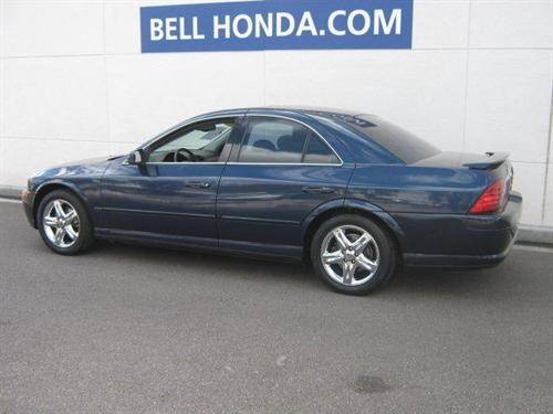

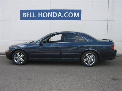

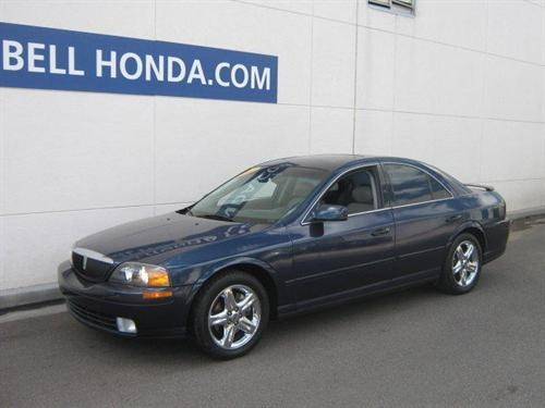

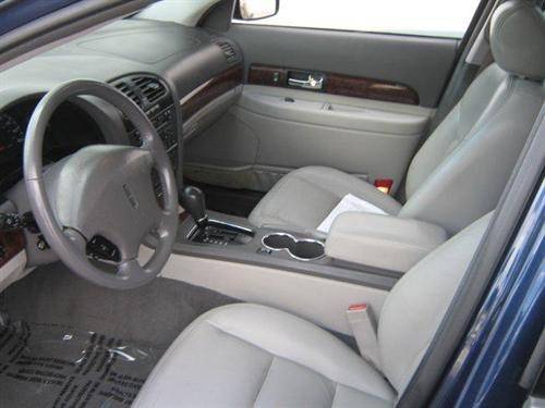

I traded my 2007 Honda CR-V for a 2002 Lincoln LS V8 Sport. Here's some pictures taken by the dealer.

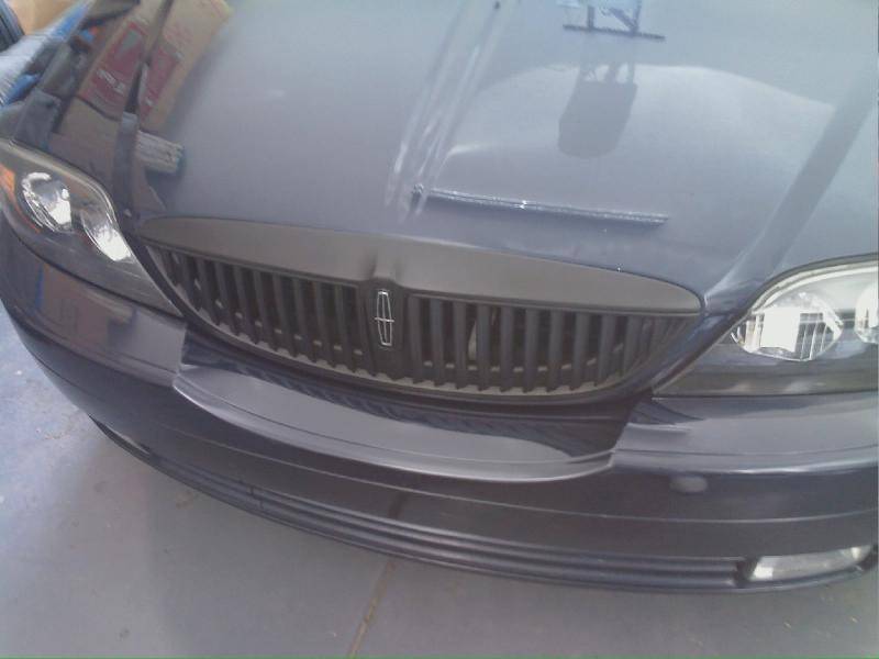

It had a bubble in the front grille chrome... so I took a pocket knife and pealed it all off and painted it black.

Looks good. But your LS appears to be blue. ?
Nice looking car! Kinda partial to the 2002 V8 myself... Good job checkin the site out first and getting all of that stuff taken care of. It seems like you got some of the major issues taken care of so far. You'll just have to take the rest as they come. The only thing I might recommend is checking all of your coils/plug wells to see if there are any traces of oil. If there is any oil I would suggest replacing the valve cover gaskets right away before you have to replace more coils than the one you did. I also like what you did with the grille but I think it would look even better if you paint the surround to match the body and leave the waterfall part black.

What's with the blue comment? Because he painted the grill black? Better that bubbly chrome IMO.
Thanks for the comments guys!
The car is blue. Don't tell me it was never sold in blue! I works for me.
Someday I may get a new grill, or have part of it painted body color... but black on black looks ok for now. (I sanded it and sprayed it in the yard using a can of black spray paint I had from Home Depot). It's better than bad pealing chrome...

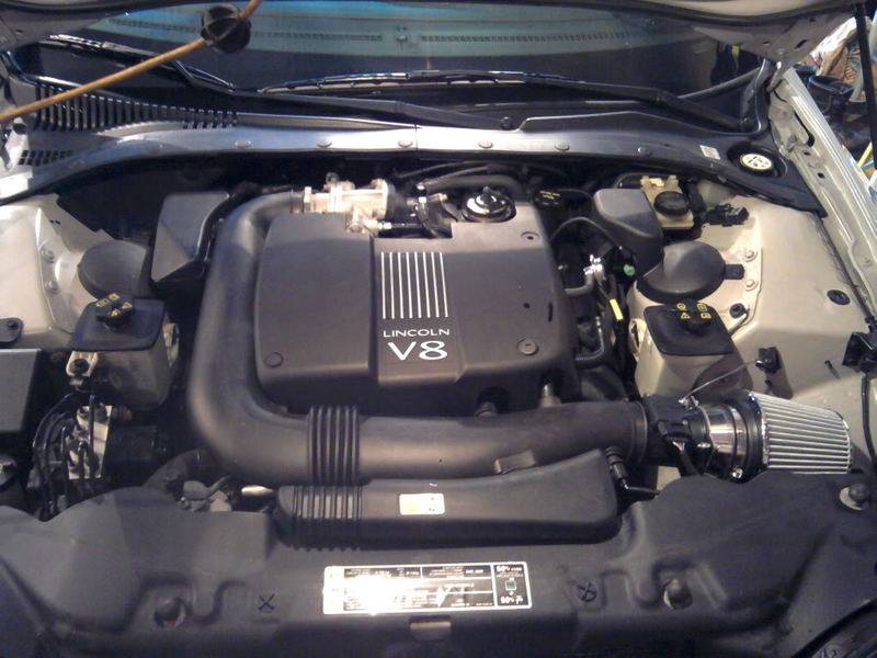

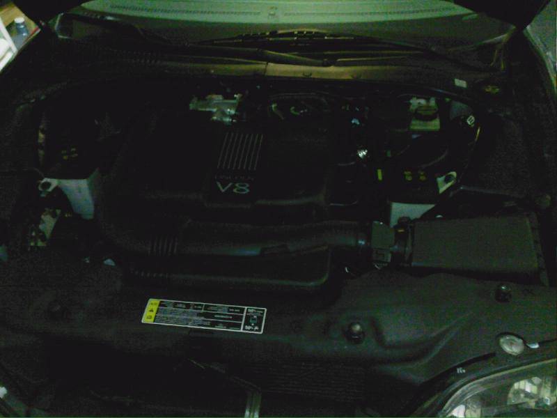

Engine compartment picture (phone pic, need to get the real camera out):

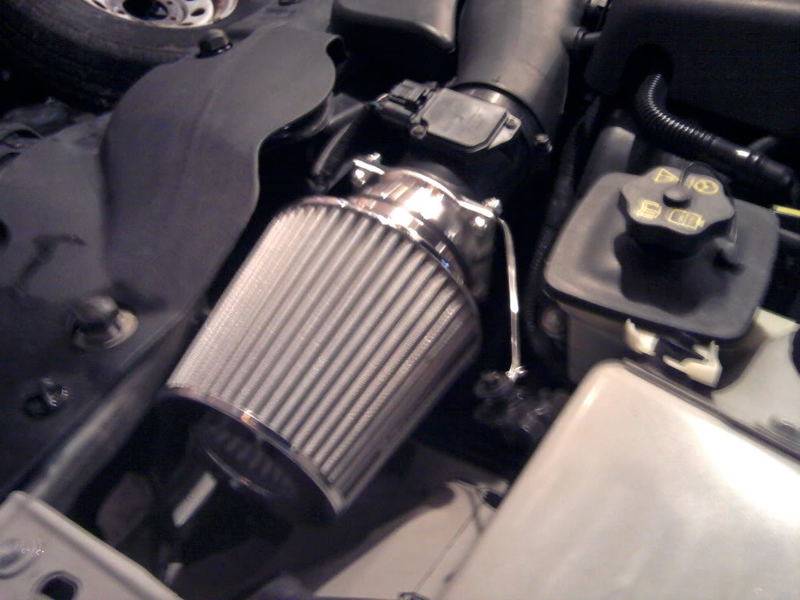

^Check my thread for inexpensive intake ideas. I picked up an adapter for $30 from O'riellys and an AEM dryflo off amazon for $40. Sounds badas and totally worth it.

O'Riellys does have it thats where I purchased mine and it was in stock. Search Ford MAF adapter on the oriellys.com website and you'll find it. Then just call the store with the part # and they'll find it for you. Its a FORD LARGE MAF adapter. It goes from 3" by the flange to 4" for the filter. Most expensive part was a reputable 4" filter like AEM, Injen, or K&N. DryFlo FTW tho
Thanks for that info, I also received email from KKM... and have updated the MAF Adapter list above.
It is not the Spectre 8146 4" Aluminum Mass Air Flow Adapter.
I tried to put that on today. It's the wrong size inside diameter air flow hole on one end (part# 8146 is the FORD LARGE MAF 4" to 4"). Mine measures more like 3.5" (2002 Lincoln LS V8). Also the mounting hole-to-hole distances are incorrect... (I tried rotating it a few times too).
I see a Spectre 8145... but still looking at other Spectre MAF's to verify the correct part. (I will update the above links once the correct part is found).
I just phone ordered the Spectre 8145 from O'Reilly's.
The local warehouse has four of them and they said one will be at the local store tomorrow or Monday.
They will call me when it get's in.
Your right, I made the same mistake when I bought mine to. The one you need is the 4" opening right?
