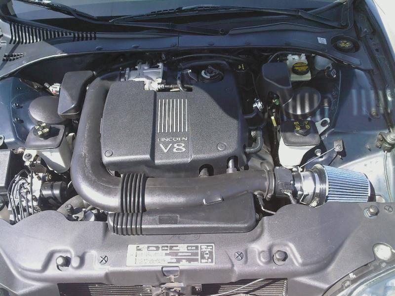

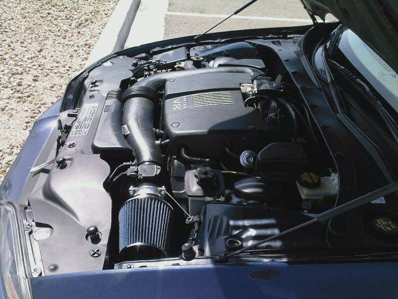

The Small Ford MAF Intake Adapter Spectre Part# 8145 for $15.99 is the correct part. Spectre Cone Filter $24.99. ($41.00 total).
Here it is installed.
(I didn't notice a throaty roar or much sound difference from it though).

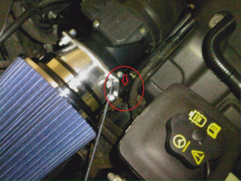

LDM, just a tip mount your bracket to the lower hole on that side. It will support it better and keep that silencer off the shroud. Also, order a new filter AEM Injen or K&N and take that spectre filter back. You'll be amazed how much the sound/performance will change with a quality filter.
For mounting, I used the lower MAF Adapter bolt and ran 12 guage solid wire down to a lower bolt in the engine compartment, then from the upper MAF Adapter bolt I used 12 guage solid wire over to the original mounting bracket bolt for the air filter housing.

Here is a picture of the lower mounting wire from lower MAF Adapter bolt...

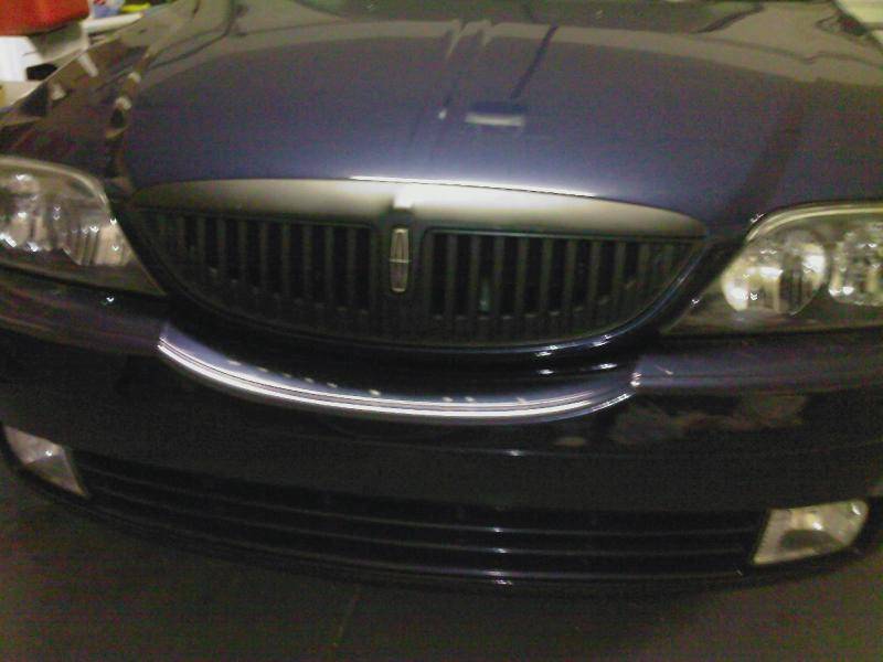

So... since the paint will be mixed for the blue car.... time to address the front upper grille.
As you can see it is a 2002 LS Grille... which had some bubbling chrome that I removed and spray painted black for now. It's a two piece grille... but the water fall on these 2000-2002 grilles do not have the chrome around it... (the bottom part of the upper grille comes from the factory all black).
To keep it cheap, I would prefer to stay with this grille... for now, and that leads me to the following:
The upper part (now black) can be painted to color match the blue car. The lower half of the upper grille would remain all black.
Do I do this now, and maybe the rear license surround to match the car color... or leave the rear chrome?

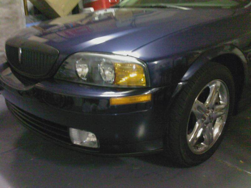

Here's some more pics (looks like the camber is off but it's the tight lens angle and cheap camera phone)

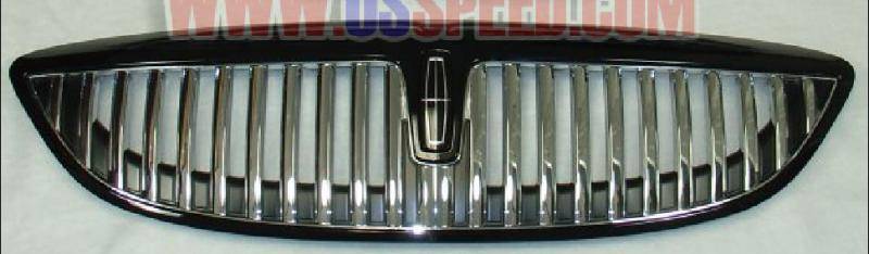

What is it you really want to know? What are you trying to accomplish?
The local Ford dealership wanted a VIN# from a LSE car that had a Chrome Waterfall Grille, preferably one that had a 2 piece grill (if that is even an issue). Everything got confused when my car was an '02 and wanting a different grille.
I told them originally to just order a '03-'06 LSE grille in any cheap color, it would come with a complete surround with a Chrome Waterfall insert... and we would color match it to the '02 Blue. The Body Shop has no problem painting it.
Some people in LVC said that some Chrome Waterfall grilles did not come in a 2 piece grille.
Just trying to order the correct part the first time.
We printed the above picture, and the Body Shop will go to the Ford dealership, but if it's not in stock to look at, it might not help Ford to order it.
A correct Ford/Lincoln Part# or VIN# would clarify.
I again said just order a '03-'06 LSE grille in any color (just not the higher priced tri-colors etc that cost more for the paint).
Getting a 2 piece LSE grille is hit or miss. AFAIK, there's no way to specifically order a 2 piece.
