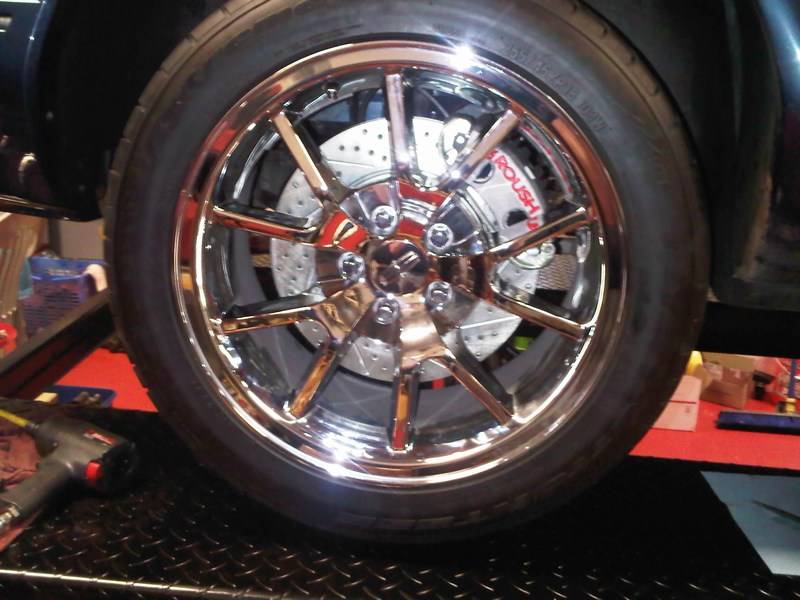

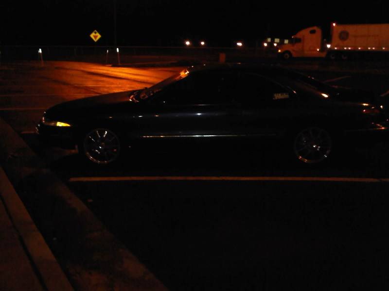

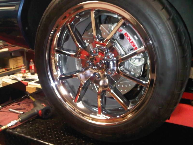

Do you have any pics of FR500's on a Mark 8??
Shhhhh....
Hey driller, what wheels are those centercaps for? I was wanting to try and find something like that for mine, but mine will be black chrome, so that changes things a little bit. Also, did you have to cut your half-shafts down some to get the centercaps to fit?
Thanks.
I found them on centercaps.net
I bought one for a test fit and then bought a set after I tried them. I think they are from an LS?
I did not have any issue with the halfshaft preventing the centercap to fit.
Hmm...I just replaced both of mine with new FLM pieces also. Hopefully, I won't have that issue either.
