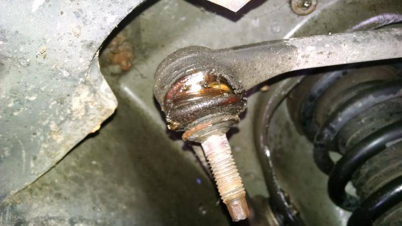

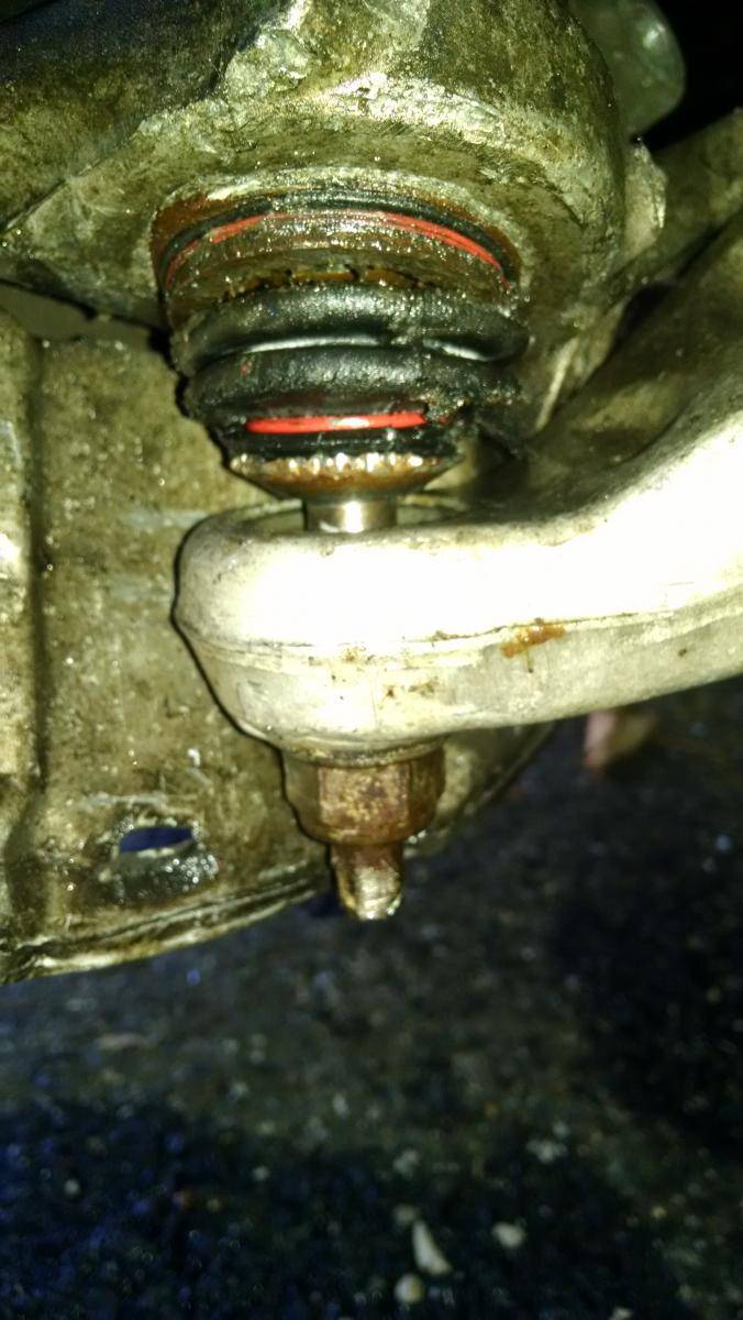

so the sounds that i hear may be just the sway bar bushing? i am going to look under it and see what i can see but as for now where can i get a oem set of all ball joints what not is it something like this for the ball joints?

so what can that sound be every time i hit a small bump its a bit hallow like

After I replaced my bushings, I still had noise. I don't remember if it got any better, but it didn't hurt (the car) to replace the bushings. I later found a loose piece of insulation/sound deadening in the passenger front fender between the wheel and door. It looked like a plastic/foam sole from a size 35 quadruple-narrow shoe. I could knock it around by banging my fist against the fender. The last piece of the puzzle was my front right upper ball joint could audibly rock around. After all 3 pieces were replaced/removed, the car stopped banging around on bumps. Now I primarily hear whatever tools I put in the trunk.
