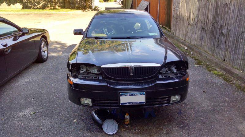

The car has always been around, made it into lots of pictures while sitting broke down in my driveway as I went through car after car, came close to selling it, glad I never did, and never will !
