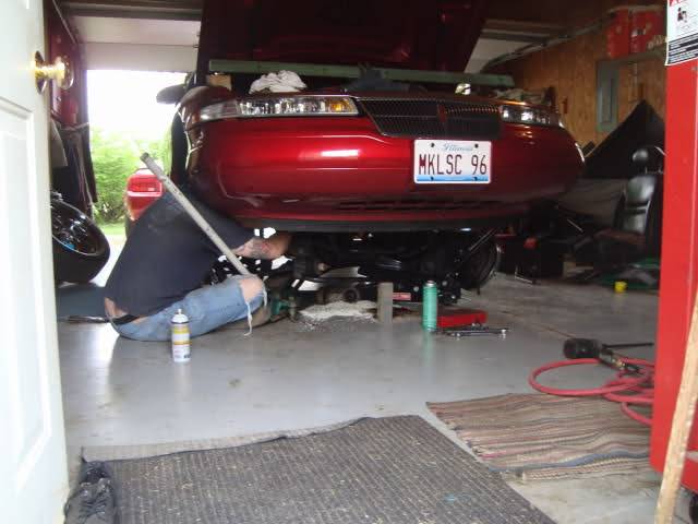

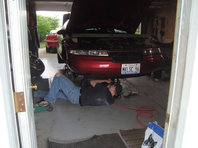

He claims to be some Mark VIII enthusiest, but he arrived in this:
but we did get it done tho
bottom end was clean, thankfully. no sludge like the commertials.
look at them rusty ass motor mounts!!! its very rare to find a sludgy bottom end. all the 4.6's i have torn apart i have only opened one that was filled with sludge, it also had 299k on it and the guy never heard the term oil change. its not hard to keep a 4.6 clean, just regular oil changes!
IDK how a car that never gets driven rusts so much... Must be a gen 1 thing... :)
It wouldnt matter if it were in a bubble, this is Illinois, sooner or later, everything rusts.
Where your pan bolts very tight? I thought I was going to snap these off but right then they would crack loose.
Fun job, eh!? I got to do mine twice when the brand new one I got from the dealer leaked as well too! grr... ;)
Between the pans and swaybar fun, I am an expert at dropping the subframe of these cars in no time :D
they are almost always super tight, aluminum block + steel bolts = corrosion! i stripped the head on one and everything i tried slipped so i used a 15mm "turbo socket" and hammered it over the washer and pulled till i heard it pop, i got it but it took along time.
