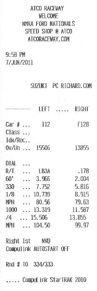

In similar conditions (DA around 1200), I went from high 14.2's @ 94.xx MPH to high 13.8's @ nearly 100 MPH (99.97). My best with the stock intake was 14.037 @ 98.46 (DA -825). My Cobra intake is stock, I didn't even port match it (yet). I did however, install an Accufab TB, IMRC deletes, and 30 lb. injectors when I did the swap. Still breathing through the stock air box with a K&N filter. Nothing else was changed, same exhaust, TC, gears, and tires. Stock pulleys. You do the math. :p
I thought a good part of the gain you attributed to tuning?

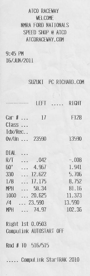

I went from 13.855 @ 99.97 (6/07/2011 - DA 1464) to 13.590 @ 102.36 the next week (6/16/2011 - DA 1059) with a single change in the tune.

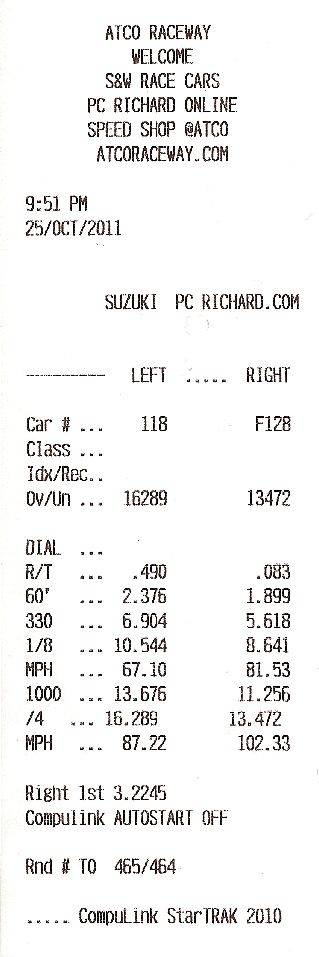

Then further tuning (and better air) got me down to 13.472 @ 102.33 (DA -614 into a slight headwind). Total improvement = .562 seconds and 3.87 MPH
And there's still more to come...... ;)

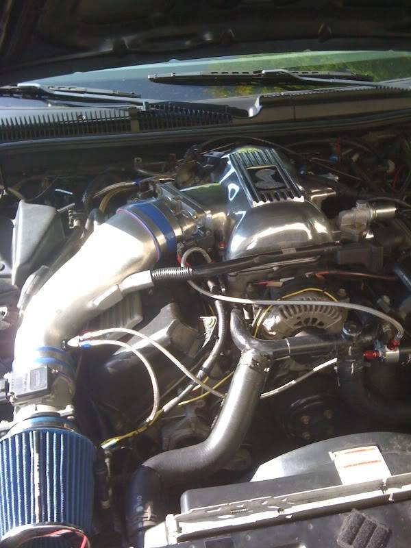

Cobra Intake Manifold, Cobra Fuel Rails, C&L intake tube and MMR Billet IMRC deletes.
