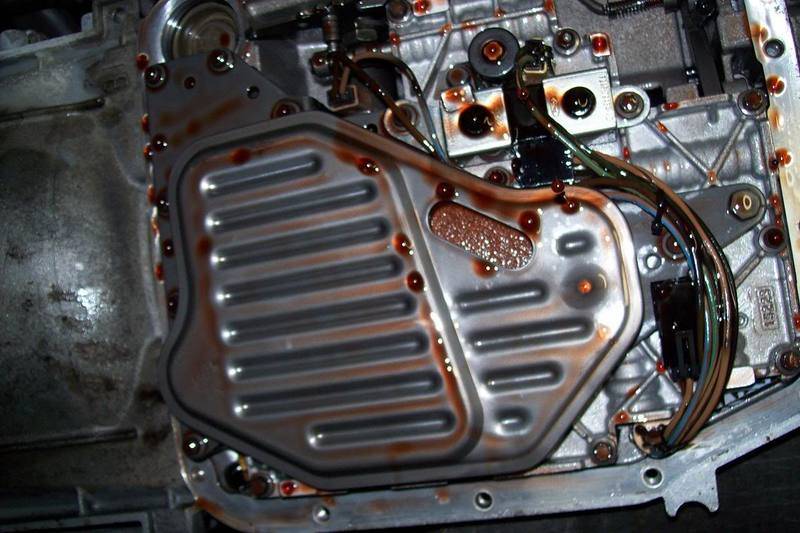

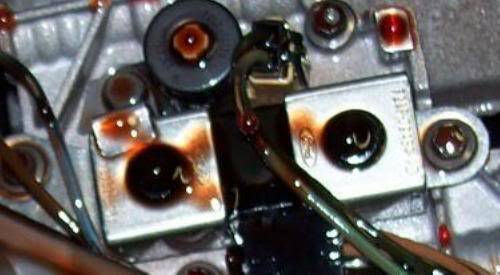

Could someone point out the 1-2 solenoid to me?
Also, very important, are they they same exact solenoids that are in my 1998 tranny that I have sitting on the floor? If so I can take the ones off my 1998 tranny so I can fix the 1993 tranny & get it going. Later on I'll buy new ones for the 1998 tranny so that I have that tranny there ready to go for the future! Any help would be greatly appreciated! THANKS GUYS!
See the round spot? With a C-clamp in place, remove the retainer clip and under there you will find the 1-2 accumulator. 2 springs and one piston. If you buy new ones, one is blue and the other will be purple. The piston you have inside there now most likely has very very worn sides and you might even find a broke spring.
This is the 3-4 shift solenoid. Usually if it goes bad, you will not have OD after the car warms up. It will start to slip out of OD and into 3rd if this part goes bad or it did with me back in 2005. I changed mine and I have had OD since. Both of the parts pictured are right at $60 each.

There is no 3-4 solenoid... the 1-2 accomplishes all tasks by turning ports on and off. 2 ports x 2 settings (on/off) = 4 gears.
From experience in my 93... You NEED the TCC solenoid from your original trans.
Also, you can either swap your wire setup on your 93 over or you can use the circuit board assembly in the 98 trans. If you use the circuit board assembly (like I did) you need to break the plastic around the TCC solenoid to get it to fit into the location on the circuit board.

What ever you want to call that part pictured in the 2nd pic does have control for the OD and the name 3-4 shift solenoid came from Craig on the .org site. All I know is when I bought it, I put it in and my OD has worked perfect for the last 4 years and then this year, I bought the 1-2 piston and springs from Ford. They don't have these in a parts store and unlikely they will be in stock at the Ford parts counter.

That part is the TCC solenoid. The name "3-4 shift solenoid" came from Craig on the .org site back in 2005 when I changed mine. I just called it that ever since and it will need to be removed and put into the 98 trans. I think it was 2 8 or 10 mm bolts and a plug that holds it in.

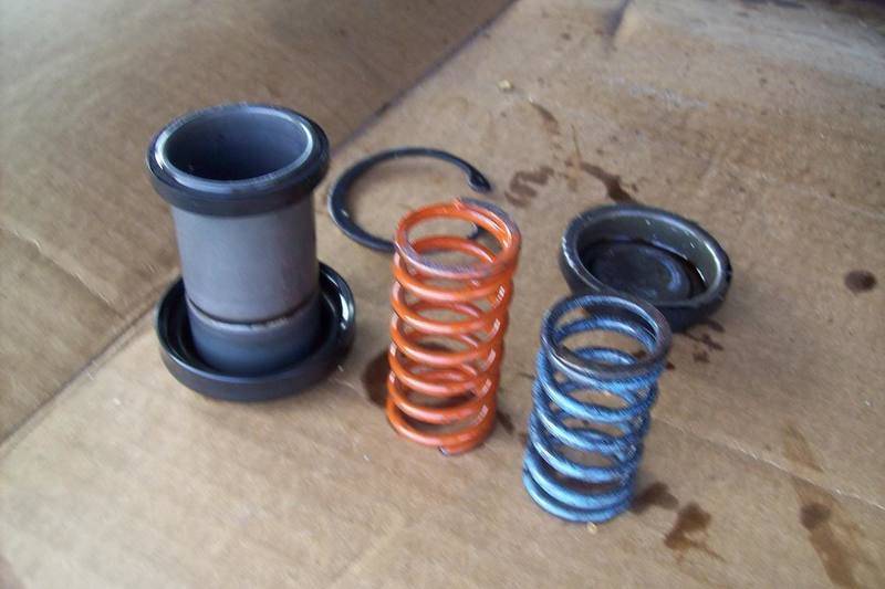

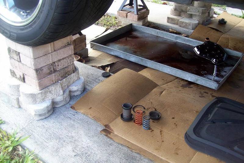

Alright guys, I took out the 1/2 shift accumulator & the springs are in perfect condition. Look at the pics below. If this is fine it means that my transmission is worst than I thought. I may have no choice other than going with the 98. Let me know what you guys think.
The 98 needs to go in. Your TC is shot in the one pictured. Valve body could be messed up, I'm not sure but it's something internal. Springs and accumulator do look good. I would hang on to the springs and retainer clip. I'm about to order gaskets for 2 transmissions. The 93 that came out of the wrecked car and a set for the 98. Going to J-Mod both and change front and rear main seals on both. I might just put the 93 in since it's a plug and play and I know for a fact that it's good. I'm sure the 98 is too but apparently it was from a wrecked car because the guy I bought it off of, bought the engine and sold me the trans. It all come from Florida and was said to have only 60K on it. I can get the 93 in quick and then get the 98 built like I want it and have it on standby. I'll take the 1-2 accumulator and springs out of the 94 and put into the 93 because I know they're updated. Not even a year old yet.

The way that car is sitting up there would have me paranoid being under it. One of those block things shatters and it's over. That's what would be on my mind the whole time. :shifty: <---me laying under there. I wouldn't be able to get anything done lol
