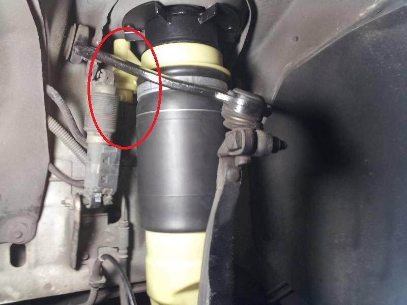

Possibly falls under the category of stupid question, but shouldn't there be some sort of an air line running from the compressor to the air bag? Because there's nothing there. :confused:
the line runs from the pump to throught the car to the solenoid on the top of the bag, look at the sides of the front Shocks and you will see them on the side should be a airline running to it.
Insert Pic of NoLimits shinny air shock:
The red circled area is where the solenoid should be with a line coming out of it.
