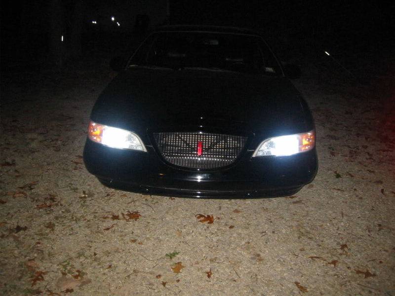

lol, if dude is lurking here ill show him how not acceptable it is.....these are better then the OEM's!
http://s536.photobucket.com/albums/ff324/BlackLSC/8000K HID Install/?start=all

Those look good! What are they, how much, and where can I get them?

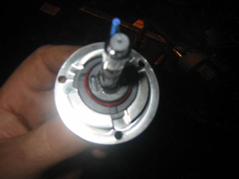

i got em from mafioso, they were like 250 or somethin, the lights and ballasts you can get cheap, check out the photbucket link i posted, the cool thing was the adapters mafioso had made up -

Not any more. I would do the conversion and sell both my working HIDs right now if I could get the adapter rings. Wouldnt mind one heat range up eaither.
Is there any way to get an adapter ring to make a mold out of? If so I'm going to contact Dario (the owner of Steeda) and see if he would be interested in CNC'ing these for our cars. He likes to work with all cars Ford and may do something for this if there is a market.
