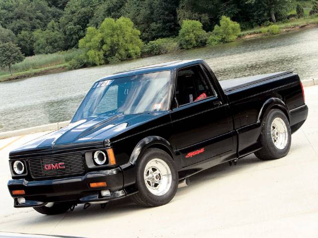

this syclone did it better
:p
http://www.gmhightechperformance.com/features/0611gm_1991_gmc_syclone/index.html
