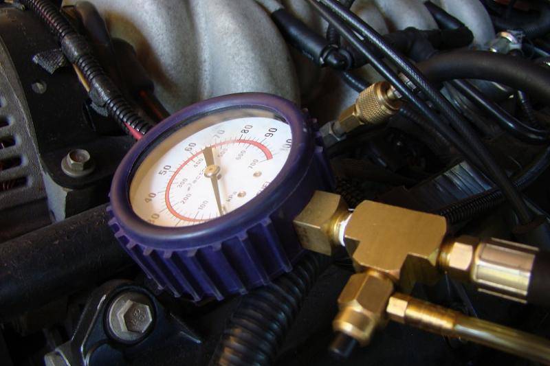

Ok,so i have never used a fuel pressure gauge but i screwed in the piece that screws in the the fuel rail and then screwed the gauge into that piece.I get nothing registering on he gauge,maybe 2 PSI but i hear the fuel pump priming.Does it sound like i have this screwed together right?As far as the IAC goes,i took it off and had my son turn thekey on engine off and i hear it whir and then it pops BUT i see no movement from the shaft.Can anyone shed any light?Could it be the FPR?
This is what i have.Does this look right?

Ok,one last update.I just got the car to start with starting fluid.It ran fine until i stopped spraying it.The fuel gauge was moving under 10 PSI.Is this fuel pump or fuel pressure regulator?I hear the pump priming every time.
Chamge the fuel filter first and check pressure again. If its still under 35ish psi with a new filter then its time for a new fuel pump. But thats your problem, no fuel pressure assuming the gauge is hooked up right.

Thats because with the low fuel pressure the fuel was "pooling" in the cylinders and not exploding. If the injectors cant mist the fuel then it cant atomize and its the fumes that explode, not so much the gas itself. Fuel was only being added like a drip from a faucet.
Fuel filters are cheap and need to be replaced every 15k. I do mine every third oil change cause of the blower and larger pump. Anyway, change the filter first and see if it helps. If not then its time for a new pump.
