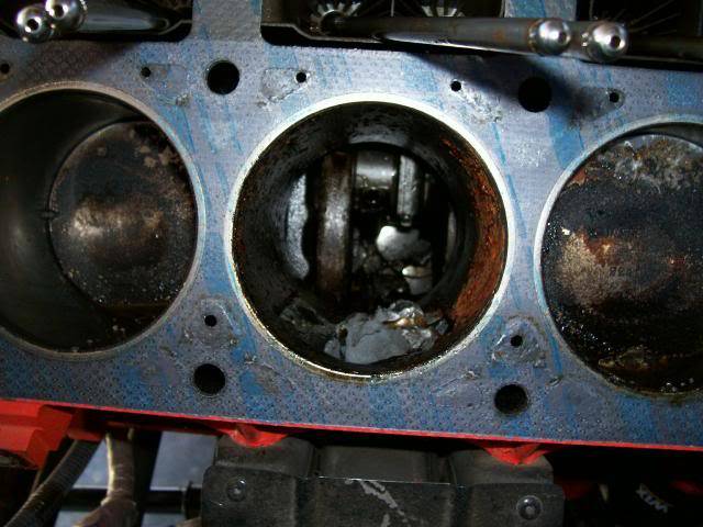

Anyway... I'm doing a heater core R&R on a 74 Continental,,, and a couple other kids are working on a 67 Camaro that the owner, (of the car), was in the process of restoring. They fired up the Camaro to do some final engine adjusments,,, and as I was doing the heater core I was listening to the engine of the Camaro, and something didn't sound right. I walked over for a better listen,,, and told the kids working on it, that it sounded like the engine was "working hard". I got called a few names regarding my IQ,,, and was told it sounded that way because it was a high performance engine with added, (aftermarket), performance parts. I then walked back to the Continental I was working on.
They shut the Camaro off,,, and about 10 minutes later, went to restart it. All I heard was "clink" , (not "click"... but "clink), every time they hit the key. The boss then told me to go put a starter in it. I told him I didn't think it was the starter, but he told me to replace it anyway. However... before I blindly replaced the starter,,, I grabbed a couple basic tools, and checked something else.
Now... to keep this interesting,,, if anyone wants to play... ,,, What was wrong with the Camaro,,, and what tools did I grab... and what was I checking for???
...Now... to keep this interesting,,, if anyone wants to play... ,,, What was wrong with the Camaro,,, and what tools did I grab... and what was I checking for???
I'll play.
It was seized because they forgot to put oil in it.
You grabbed a pull handle and the correct sized socket to see if you could turn the crank by hand.
Ok Joe. I was waiting to see if anyone else wanted to join in,,, but guess not. To finsh the story:
I grabbed a breaker bar and socket to fit the crank... and yes,,, the engine was seized.
Good call on your part.
The engine did have oil in it... but after the engine was pulled and the pan removed,,, the oil pump was found lying in the bottom of the pan. OUCH!!!
Not sure who did the engine work,,, but evidently someone didn't know how to use a torque wrench... because the rods and mains were both over-torqued also. The bearings had to be chiseled off the crank, and the crank was severly scored. Some thought it could be polished, but IMO it would at least have to be turned... if it was even salvageable. I never saw the cylinders or pistons. I didn't stick around that shop long enough to find out.
Point of the story... be careful who you let work on your car!

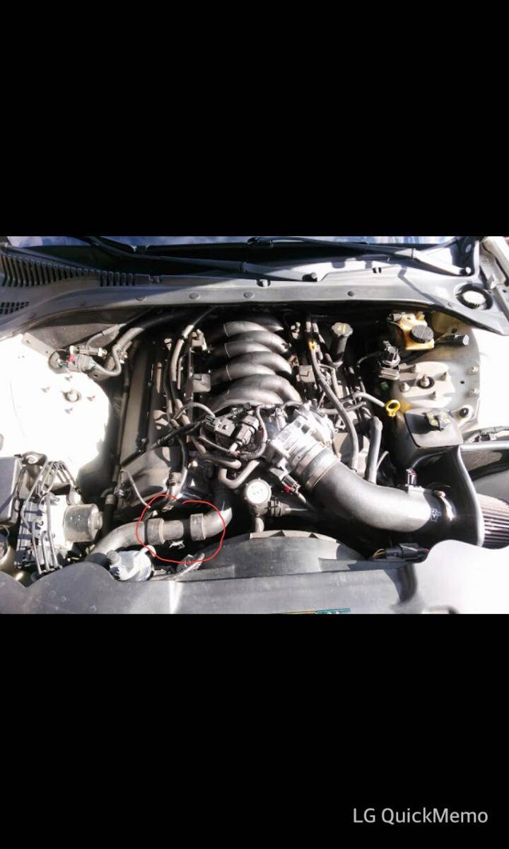

uploadfromtaptalk1433643704236.jpg this hose is also part of the cooling system I haven't seen many suggestions to replace this hose why is that
