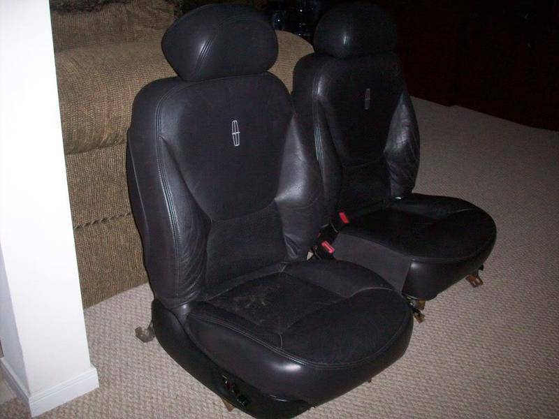

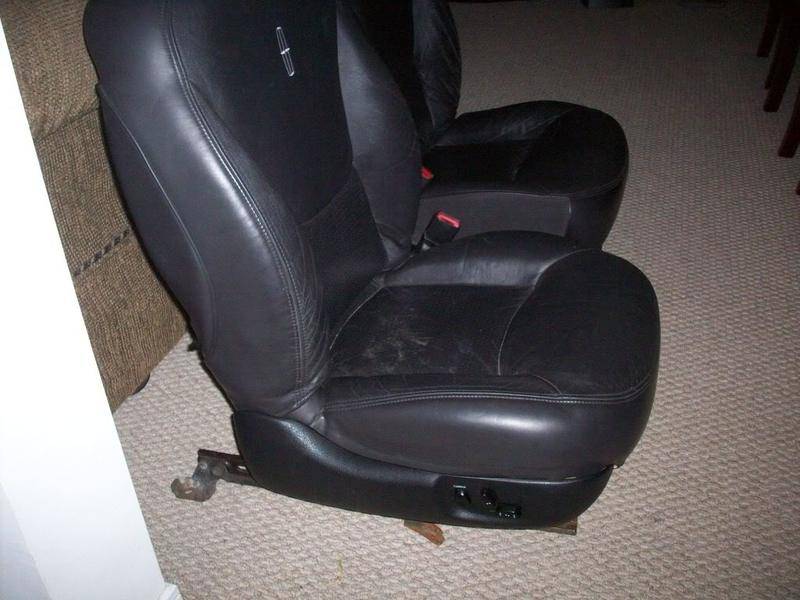

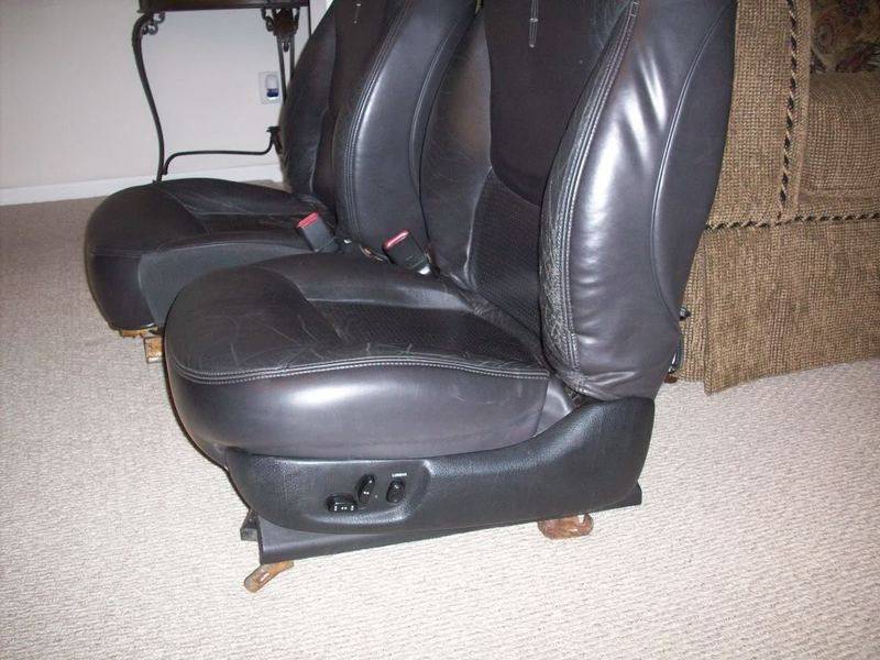

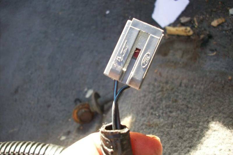

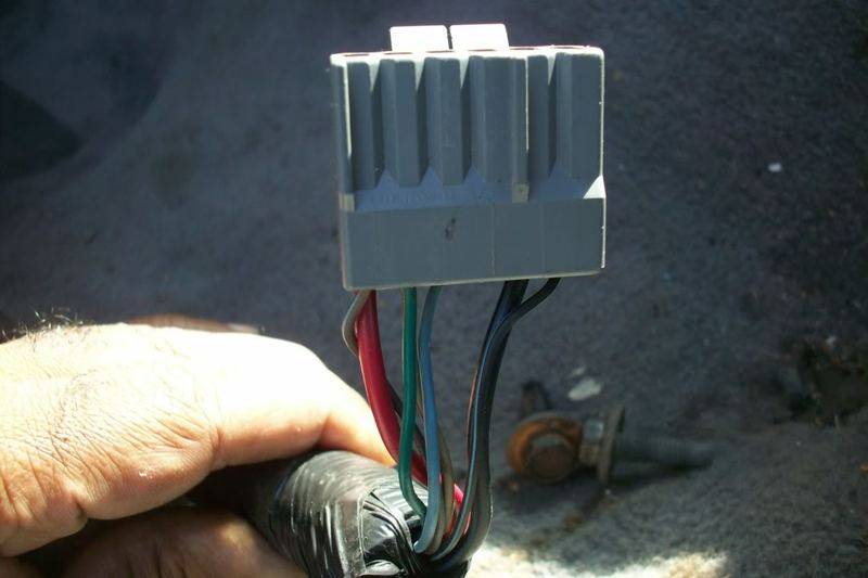

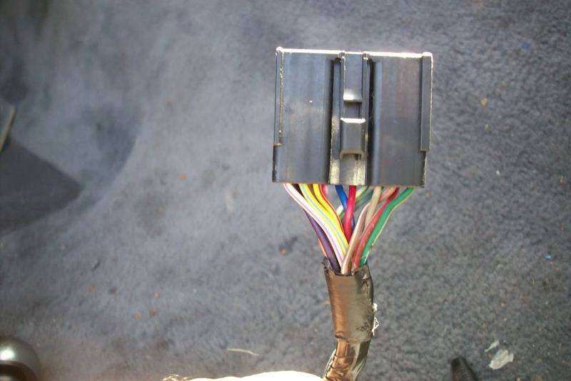

Ok, I have all the pieces to get this to work, but I am going to need some help/input from some people. Many of us who own gen 1's want to put gen 2 seats in their cars. Every post has been it can't be done. That's actually not true. There's going to have to bee some electronics work needed, some cutting and splicing and soldering. Electronic schematics reading is not my strong point, as a matter of fact, I can't do it at all. What I need is someone who would be willing to read the wiring diagram for the 93/94 Mark, and the diagram for the 97/98. The connectors are clearly different, all that needs to be done, is figure out what wire does what.

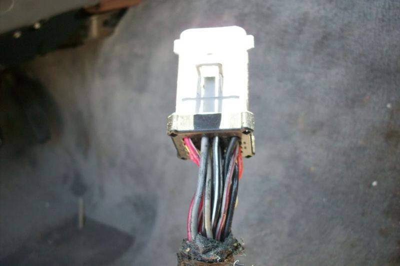

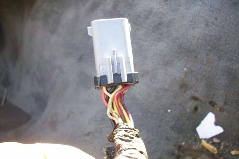

Gen 2 connectors.

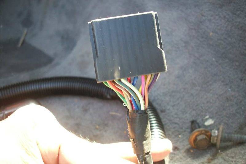

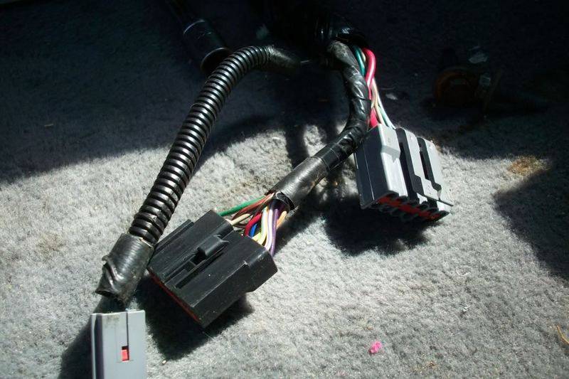

Gen 1 Connectors.

The gen2 dash was totally plausable, I gave up on it, because removing the wiring harness was a pain, and not worth it. The seats on the other hand should be a piece of cake. The gen 1 actually has more wires going to the seats. The only thing that has to be figured out is the glide, and all of the controls. Once these are found, It's just rewire.

You're looking at this from the wrong end. You should swap the whole seat harness and all the modules from the 1st gen seat to the 2nd gen seat, with the exception of the motors. The connectors on these are the same between the two gens. You will have to wire in the electric motor for the lumbar on 2nd gen seat, since the 1st gens use a air pump.

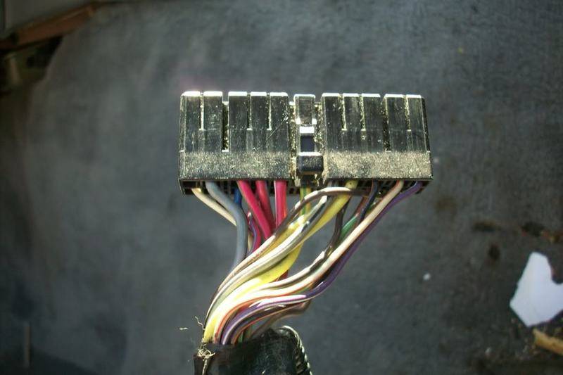

Gen 2 connectors.
Gen 1 Connectors.

Anyway, the most people tells you the truth: Control modules are TOTALLY uncompartible, Gen2 uses Multiplex Network, Gen1 does not. All 'external' features, like memory, slide back (after removing the ignition key) will not be available. Maybe, it will not start at all, due to 'no answer' on MultiplexNet. The only way to make it fully functional is to use Gen1 module with all the other stuff from Gen2.
gen one seat tracks will work in a gen 2 and vise versa no soldering required just used the wire harness off of the old track and scrap the replacements harness all the motors are the same
now the seat control are a different story if you want your gens seat controls they those have to be wired in.
I have a 95 seat track on my 98's driver side.

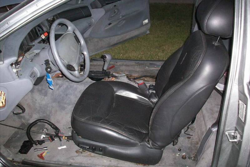

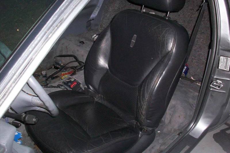

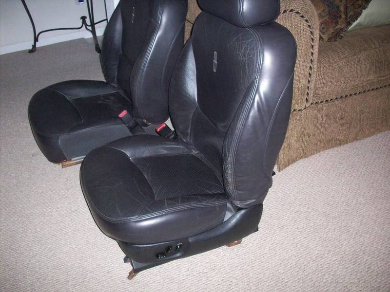

I am the first to say that I totally backed out of trying to wire in in the Gen 2 seats to the Gen 1 connectors. None of the connectors matched, and it was totally going to be a PITA. For some reason, I thought swapping over the skins would be a PITA, because of the hooks, that needed those hook connectors. Well I am happy to say that after I cut the hooks off the Gen 1 seats, I didn't need the hooks on the Gen 2 seats. :) The foam just had the velcro. The only thing I had to be careful of was removing the velcro from the foam, because since the was starting to decay and come apart., I had to remove them very carefully. Once i got them removed, everything went back together easily.
look great greg, i'm glad that in the end you got something to work out for you, but i hate to say i told you so!!! i'm not always right, but i know when something isnt worth it. reguardless now you got gen 1/gen 2 seats!!
Yea, I had it in my mind that taking the seats apart was going to be a PITA. It's a good thing to, the Gen2 plastic was falling apart.
