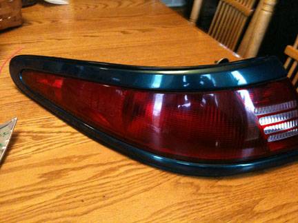

Gen 2 LED Tail Light build for Sequential
MediumD
Apr 4, 2006
2,874
Albuquerque, NM
Looks like it was made by Whelen, Code 3, maybe Federal Signal. :D
can you send me a list of all the parts and where to get them so i can attempt it for my gen one i have access to a couple of extra tail sections, and would be interested in doing this to my car. any more pics would help also. thanks
1. About a billion LEDs.
2. Soldering gun.
3. About 4 pounds of solder.
4. Import some Chinese kids to do the soldering for you.
Personally, I don't care whether or not I have sequentials, so I just plan on using a few premade LED strips off eBay.

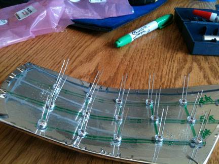

If I were doing a Gen 1 car I would just swap out the bulb holders for dual element holders (from the parts store) and buy LED bulbs (no heat).
then run wires from the sequencer for the break/turn portion.
I got all of my LED's from superbrightled
http://www.superbrightleds.com/cgi-bin/store/index.cgi?action=DispPage&Page2Disp=/leds.htmsequential box from webelectric
http://www.webelectricproducts.com/products.htm, if you want chase and sequential you can use the one from merit4 but I believe he quoted me like 180 for one to do 4 segments per side.They do look nice. http://www.meter4it.com/
If you go with DIY route you'll also need resistors and diodes which can be found just about anyplace as well as the formula to get the right parts for the LED's you pick. Here is a good one. http://led.linear1.org/led.wiz

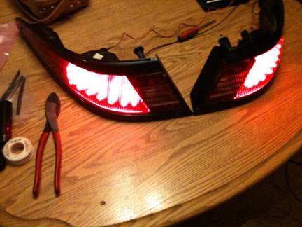

I say you need a diffuser, and tint them, direct led's look cheesy all the little dots, and theya re way bright. I think it's a good potential project, if you perfect it I have a donor tail light like Jamie does, ready and waiting. My neon is broken and I'd rather do something custom for a repair rather than fix the stock stuff, as that is my theme for the car, fix all the broken stuff with custom, lol.
MediumD
Apr 4, 2006
2,874
Albuquerque, NM
I don't mind the look of individual LEDs showing, but it will probably look a bit odd if the other taillights are stock.

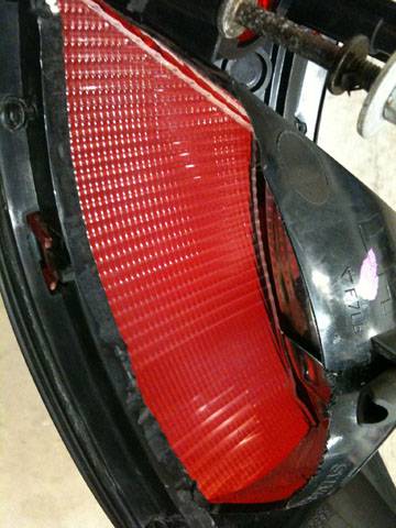

I picked up a light lens panel (clear textured prism for overhead lights 2x4) and cut the template. I'll lay it in and put a little heat to it to mold it to the light. I think you'll still see the individual led's somewhat but it should give it that prismatic effect of the factory tail lights.
I'll get pictures up once I'm finished.
Lots of little details for a tail light... I think it will be worth it in the end.
