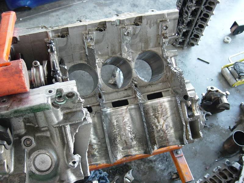

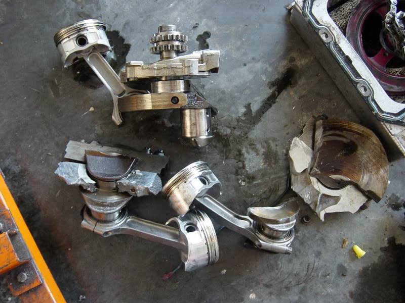

sapperr you guys are awful lolol -- i know you're just joking - after 38 years with the same old Woman i know you are joking -- heck they have half the money and have all the u know what ! -- wife is driving my 94 to work 60 miles a day --- i go out and have a walk around often lol -- she loves it --- 49,000 miles on it now - she's put 5,000 on it sense we got it -- before Christmas --- maybe ill get a good shell -- black on black - good start. build a motor , turbo or 2 -- 6 speed 3:73s -- heck a single turbo would do for a driver -- if she ever gives it back!! :rolleyes: pic is of a teksid that the crank gave up at high speed -- yikes - they do blow up -- it had a high speed comeapart no doubt :eek:
Cast crank from what I can see.. plus the scoring on the counter weights = crank walk. Pretty common actually, I've seen quite a few 5 speed 4.6 cranks that look pretty close to that. 03/04 cobras tend to do bad things when some azzhat does a 5th gear pull out on the freeway.
That block has seen better days, looks like a couple of gremlins got in there with hammers.
A little JB weld and it will be good as new. :)
