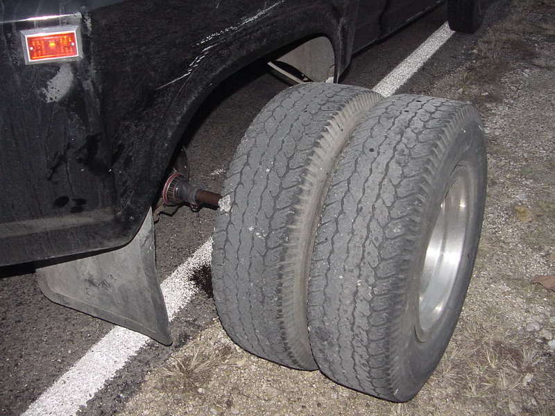

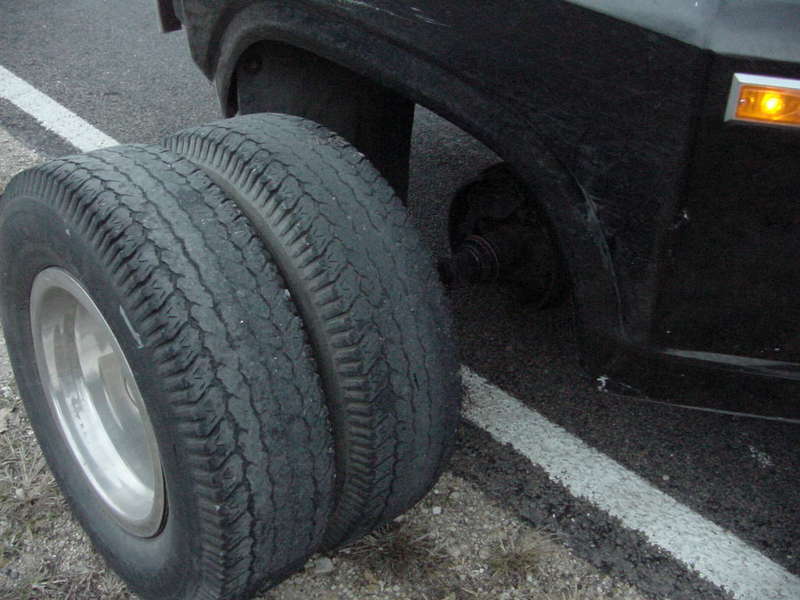

For as many years as I have been driving, licenced and not when I was younger, I never once EVER thought about checking gear oil before I journeyed home with a new used vehicle.

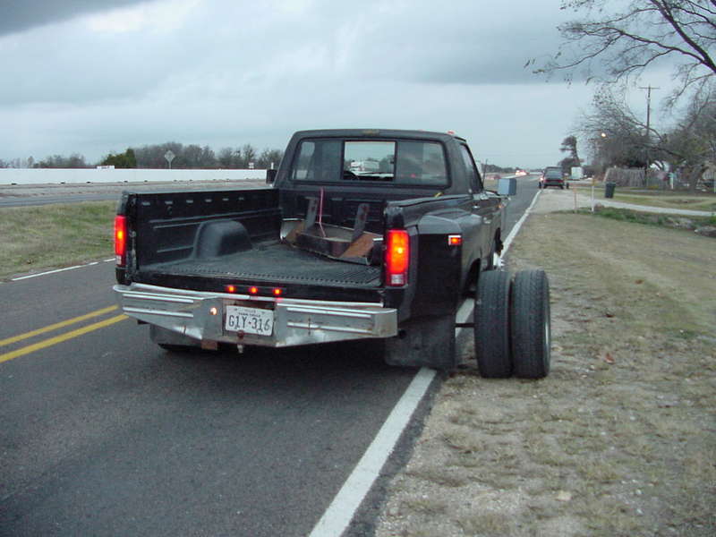

Well, let me tell you that will never happen again, I bought a F350, and was bringing it home and got 25 miles down the road, on I-35, one of the most busiest hwy's and had this happen to me at 70mph, now remember, when the drum is no longer in contact with the shoes, there are NO brakes:

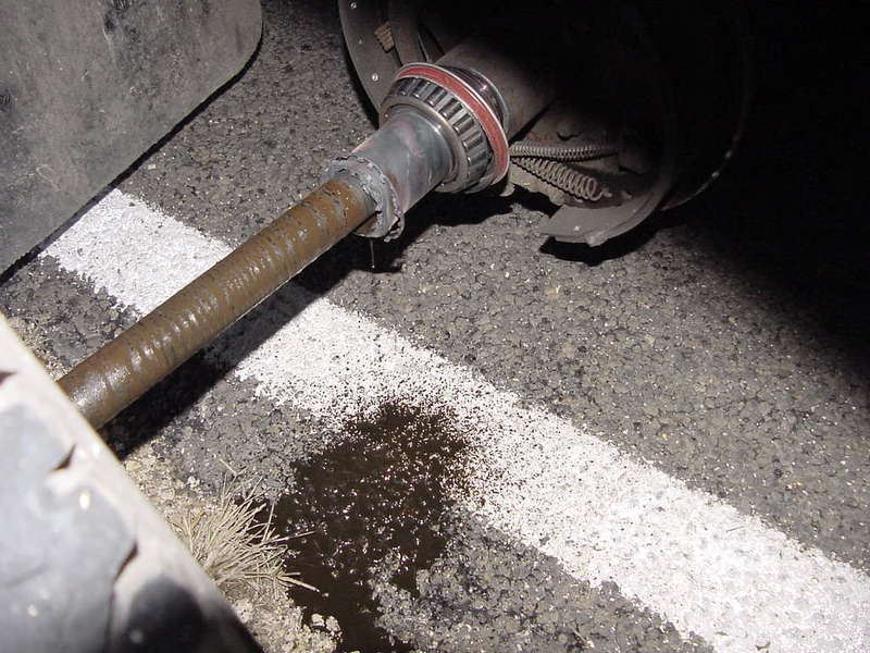

You gotta love full floating axles, but only when thier full of fluid, note the dry bearing and axle housing, the bearing siezed on the axle housing/hub assy causing it to shear off and depart from the truck, the housing is wasted, this is a complete rear axle replacement because of this ($650 plus, used).
Correct fluid amount as you can see can be crittical to the parts you trust, it made two squeeks and then let go, no other warnings, and as you can tell by the sky, shortly after the pictures the sky opened up and dumped tons of rain.
