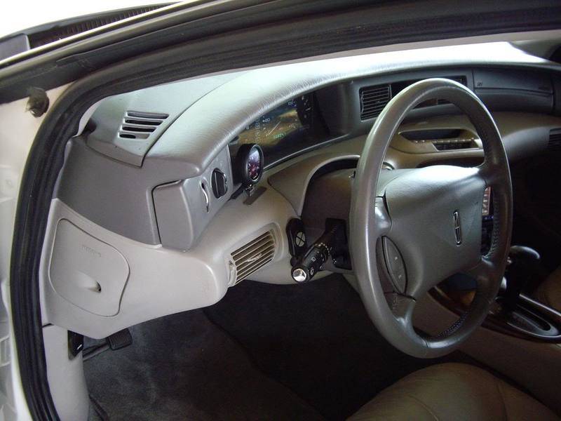

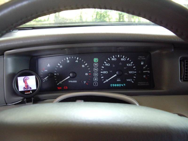

This would be great. But from what I saw I do not think it would work with my 93 (not OBD 2). Did you mount it in the car ? Got a picture ? Thanks Don
I am mobil so can't post right now but there are pics in my progress thread. They do have an OBDII interface but mine is the other version. You just buy moduls for what u wanna read.

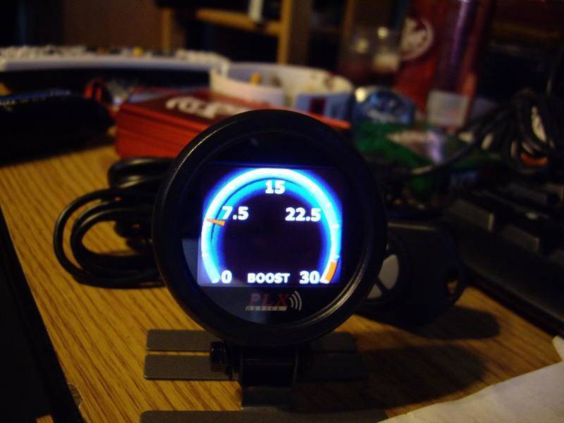

So let me give you the skinney. They make two gauges, the DM-100 and DM 200. I wish I would have gotten the 200 cause its larger and since I have ine set to read 4 paramaters it would be easier to see. They then have the OBD 100 and OBD 200 which is the same gauge but reads off of the OBDII port and anything the computer sees the gauge will display. Again, wish I would have gone that route so that I didnt need to buy a module to read IAT or timing and other stuffs.

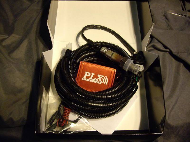

So I have the DM-100 ($190) with the wideband AF module ($170) and the boost module ($80). I can add 30 more inputs if I wish and will soon add the IAT module and the fuel pressure module. I like the gauge cause its accurate and fast plus it looks cool but I do have a big gripe. If you have it display like a normal gauge then it cant display boost and vac at the same time. :( Not a big deal for me cause I have it in numeric mode and have one line for boost, one for vac and one for A/F.
You can also download custom backgrounds and gauge faces for it which is pretty cool. They have modules for anything so you can read as much info as you want. One other minor downside is each module is the size of a pack of smokes and you have to find places to hide them. Mine are beside the steering colum.

They also have a square gauge that shows six areas at once that would fit perfectly into the center display opening. I wish I had the drive to take my display apart and replace it with a color LCD screen and then write the grafix for it. That would really bring a modern touch to the car.
Although because of the touch screen in my car and the USB (thanks GMAN) I grafted into the dash people never believe the cars is from the 90's anyway. :lol:
