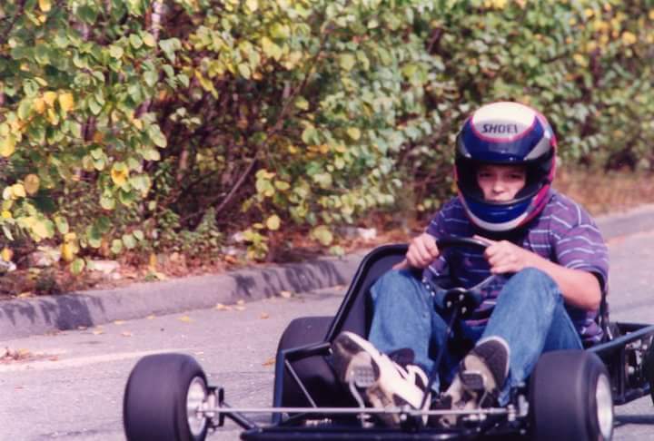

Started life as a 5 horse 2 seater fun kart with knobbies. It suffered a slight ride plane inversion (flipped over) then got reworked into a lower and wider version with Bridgestone slicks. It would understeer like a bizch with a SRA that we later cut in half, and added second 5 horse briggs to drive each side. It was only chain/sprocket driven and would go a tick under 50 with the engines' centrifugal speed limiters removed. It would pull enough g's that oil would crawl up inside the engine and come out the exhaust. Here's me about 20 years ago trying to pull myself back into position...

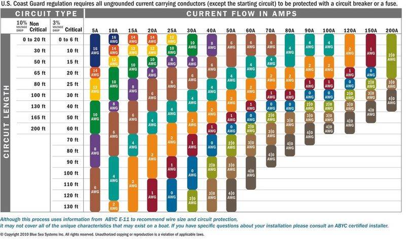

Wire the individual lights with 16-ga to the switch panel or bus, use 12-ga for the charging circuit from the stator, and 10-ga for the starter. If you add a car alternator use 6 gauge for it. Also install a good grounding strap from the main frame to the subframe the engine is in and make sure the battery has a good ground to the frame as well. I'd probably just run the ground (negative) to a ground bus instead of using the frame for most of the lights too. Otherwise you're going to have to tap the frame in a few spots to get a good ground.
