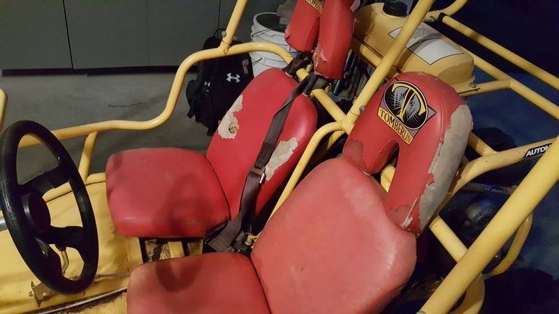

the idea was to find a kart for my sons 12th birthday. To A.) be a cool gift... B.) teach him how everything works / start learning some simple mechanical systems.... We wanted something solid, w/ a good motor, and had suspension. The rest not to worried about, as we will R&R as we learn and upgrade.
Came across this:

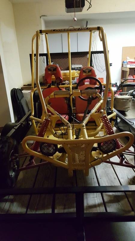

Mid 2000's Tomberlin Crossfire 150
I believe its their "first gen" base model
Owner/kid's CL ad was a little deceiving, but again... the more wrong, means the more he'll learn.

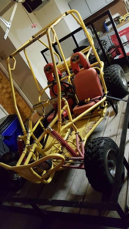

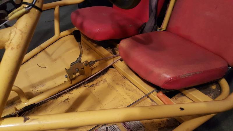

Frame = great, no rust (Just paint weathered)

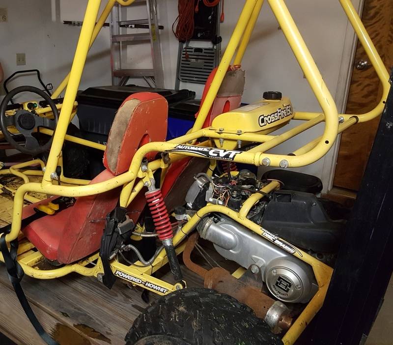

Engine = Howhitt 150cc (GY6) Runs, strong compression, carb gummy....its w/ a small engine guy getting a once over (I wanted his opinion...Jedi of small engines)
Brakes = work, but will be R&R

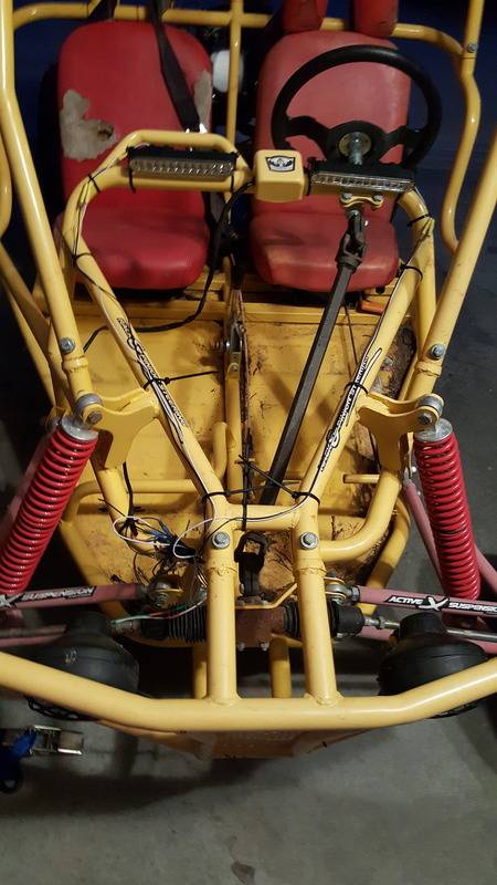

Electrical = works, but butchered... will need to reverse everything thats been done

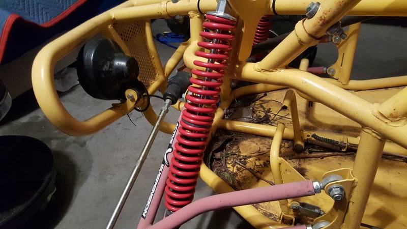

Suspension/ tires = works, but will need upgrading

1. building a dash... will be upgrading from the 6 pole stator to 11-pole, to run more accessories, thus need a spot to mount switches and hide wires / fuse box... thinking a decent gauge sheet metal bent and shaped will work on its existing spot..

found a bad carb diaphragm, and a small intake gasket leak... should be good after that.

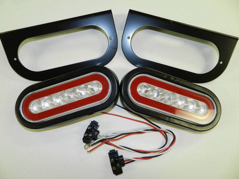

Ordering a few parts.... want to add Brake lights
Option 1) Inner lights will be running, no reverse though (will have to add as its own bulb)
option 2) Trailer light bars... Will have running, brake and reverse all in one (not a great place to mount thought)
Option 3) (traditional)
Back of kart (no light currently)

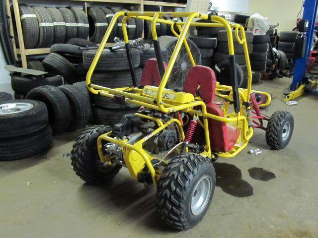

Those puddle underneath, no worries ... just replace all plastic plumbing, use OEM only! Bleed system as per Tech procedure.

Go with the reverseless taillights, then mount some mosquito-melting light bars for reverse. I'm guessing the outer light rings are meant to be running lights with the inner lights being the dedicated brake lights, given the color of the lenses and the seeming lack of optics on the ring
Unless you plan to add turn signals I would just get one long red bar and put it where the old brake light is at. That way you got lots of visibility in case he ever ends up on a road or being followed.
Otherwise the one with the rock guard. The rounded one just seems out of place to me.
