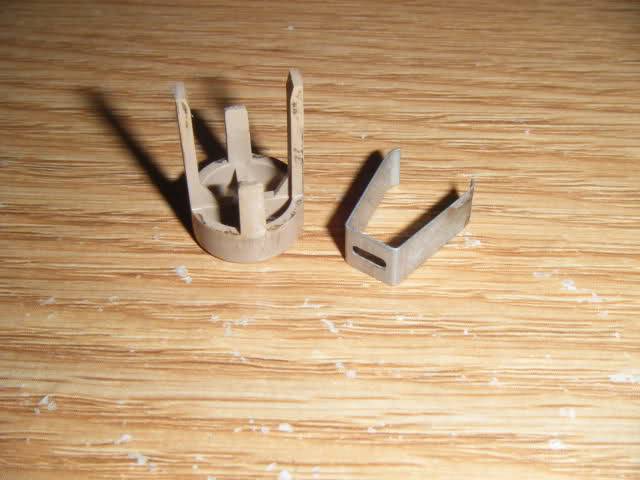

his is the same, just the button itself came out. and heres the tabs that broke off of it allowing it to shoot out
Yeah, those tabs are what I was talking about in my first post. I'd send you a button for the cost of shipping, but you'll probably want to get one from Jamie. I'm out of town for about a week.
all years interchange some are chrome thats all, i have fixed the buttons in the past. the tabs break off and i have used screws from a pair of glasses to make new ( wings ) to put the button back together but they are so easy to aquire its not worth fixing them.
are the tabs on the short or long peices? I know they belong on one pair of them but neither show signs of sumtin breaking on them.
yea, i got that part...But you got the 2 long parts and 2 short on the actual inside button..I put tabs on the short ones i just want to make sure that they dont go on the long ones before i try to put it back in..
they do go on the long ones, look up chicken circled the part that broke in that picture.
yeah, i saw that part. I dont have the whole button/assembely out so i couldn't tell for sure which one it was before..Thanks though..
