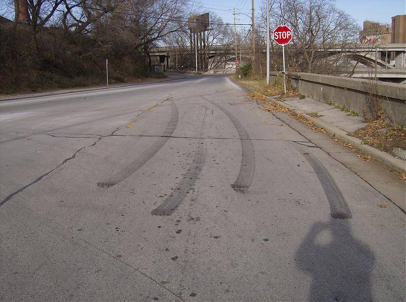

Figured I'd add this pic and videos here as the original threads have faded off.
http://media.putfile.com/02-LSE-0-60
http://media.putfile.com/02-LSE-0-60-wspinning
