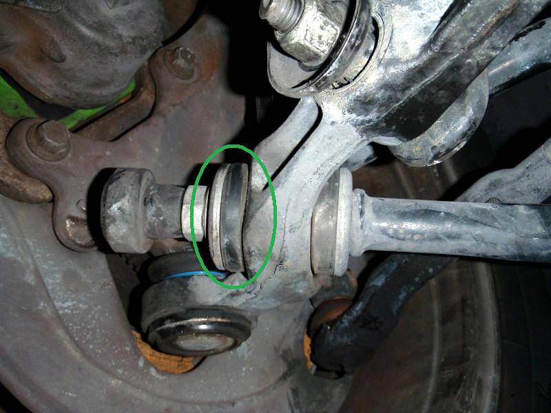

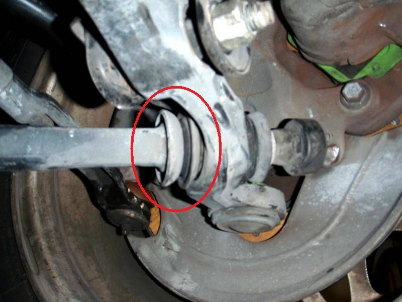

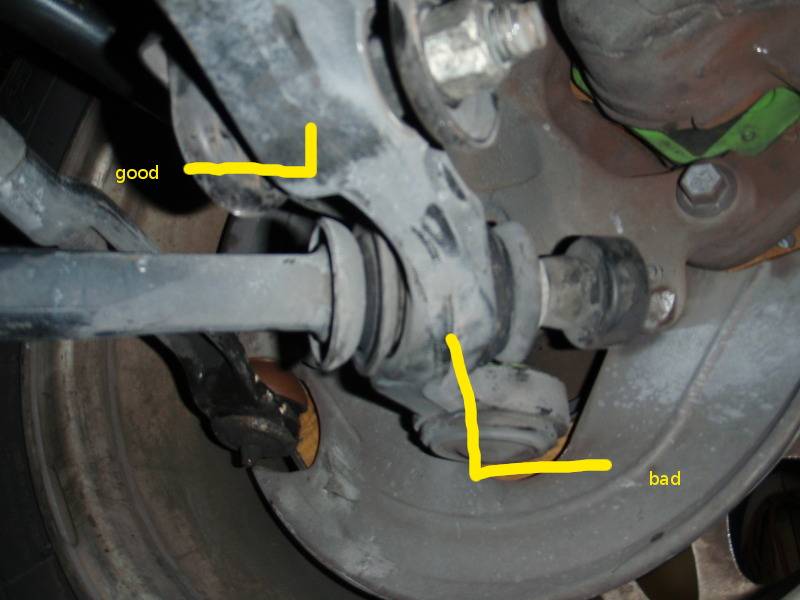

When my car was up on jackstands I took pics of the front suspension. Jamie pointed out that front strut rod bushings were new on one side and bad on the other. He also pointed out the ball bearing boot was torn and bad on the passenger side. I think in one of the pics something else seems to be missing a bushing entirely but don't know.

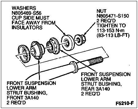

I was also curious if I bought a whole new control arm I know it comes with a new ball joint, but does that come with new strut rod bushings as well or is that separate?
Here's the pics. Let me know what you all see.
Also I found my cross-member brace has one bad bushing/mount. Could that have caused the clunking I would feel sometimes?
