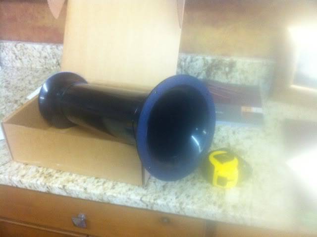

Got the aero port in today:
Now, I'm tempted to get the 3/4 birch from Home Depot. 44.95 a sheet. My custom place has awesome 3/4 11 ply birch for 51.99. But then I'd have to pay shipping, or wait for another order. I'm rather impatient lol.
