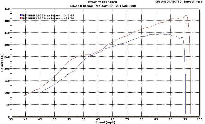

THere are tons of others but most show an increase in diameter=an increase in power. THose little honda 4s are running 3 inch I would think a big mightly V8 can... I got 5 inch on my 5.9L straight six truck lol.
Backpressure is a myth, unless you are running 2 strokes that need tuned pipes. And even then its not the pressure its the speed of sound vs your reflection cone and stinger length.
