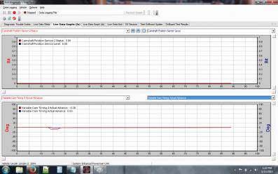

So, yesterday I had what I thought was a coil go bad, rough idle. I hooked up my PC driven Autoenginuity to the LS for the first time. I found that I can measure/read cam timing. I'm curious to see if I can use this scanner to show a story behind the rattle at start up.

MPD4200,
That's actually not a bad idea. But you would also need an oil pressure test gauge. That way you could observe any fluctuations in cam timing,,, up to the point the engine reaches 22 PSI... which is when oil pressure is restored to the cam phasers after leaking down. However this may not be 100% conclusive since there are other oil pressure realted components, (tensioners).
If you decide to try this... let us know the results.
OK,
Now you got me thinking about this. The LS 3.9 only "phases" the intake cam,,, so if your scanner can monitor the intake cam and exhaust cam simultaneously but separately... this may work. In theory... if the cam phaser is the issue,,, you would see fluctuations in timing only on the intake cam. But if a weak tensioner were the issue,,, you would see fluctuations on both cams.
Great points on the intake vs exhaust cams. I wouldn't have thought of that or the oil pressure.
I can monitor oil pressure. But, it's what the computer thinks it is and may not be true.
I'll give it a go and see what I can capture.
I don't recall the exact cam timing I was measuring last weekend as there were a few available. But, it was fluctuating a few degrees every 10 seconds or so at an idle.

I'll add a flush additive today. I have to draw a small oil sample for analysis first. I'm overdue for an oil change. I'll use the recommended oil type weight with one quart trans fluid for a month or so and then switch to rotella syn blend.
The scanner does show one cam timing measurement retarding timing until my rattle stops. I'll share this view ( I hope) now as I work towards a better view. I can only do the cold start rattle once per day as after the first start, it doesn't rattle again. Surprisingly I can't measure oil pressure with the scanner. I'll look for other useful info to tie to the cam timing.
BTW, the timer on the bottom of the chart starts when I press "record" not when I turn on the key. I'll show another view with engine RPM as it's easy to see when I start the vehicle.
... Surprisingly I can't measure oil pressure with the scanner. ..
Not really, sense there is no oil pressure sensor on the car. There's no way for the PCM to do anything but guess at the pressure. (The oil pressure switch just has two states. No pressure and enough pressure.)
