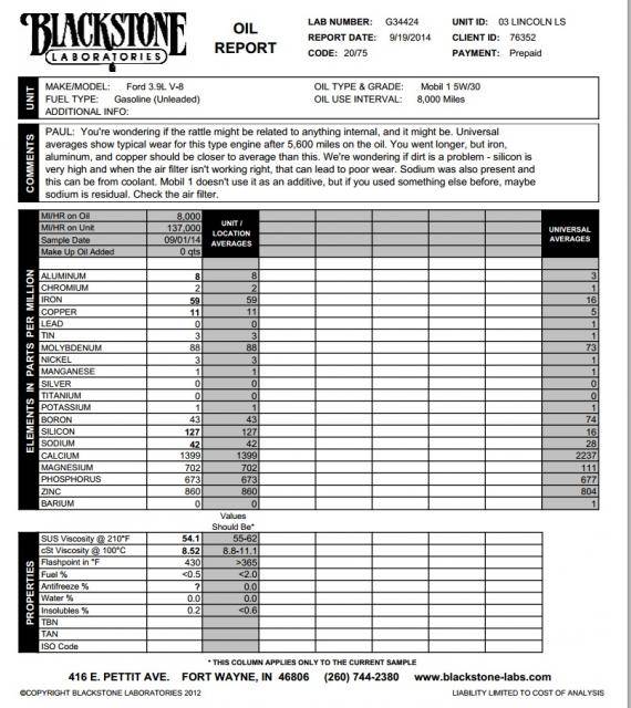

Got my oil analyzed, seems like aluminum, iron and magnesium are 3x to 6x normal. Does look like an internal issue to me and while it does stop after less than 2 seconds it sounds horrible and this analysis looks really bad. Now thinking it may be a cam rattling around. It's not secondary tensioners on my LS as I've replaced those.

I'll be due for an oil change in a month or two. I'll certainly send a sample to Blackstone and post results here. The rattle in mine seems to be getting worse. Kind of a predicament, can't sell it as is for any decent amount. Guess I'll keep an eye out for a replacement engine. I did search for a rebuild kit without luck.
