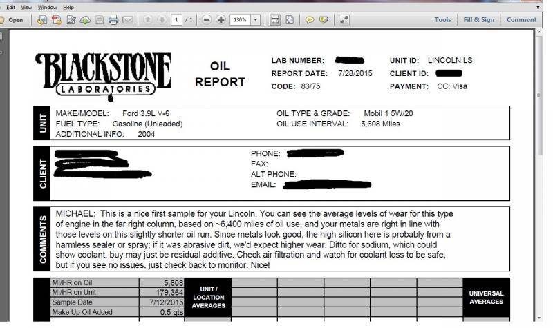

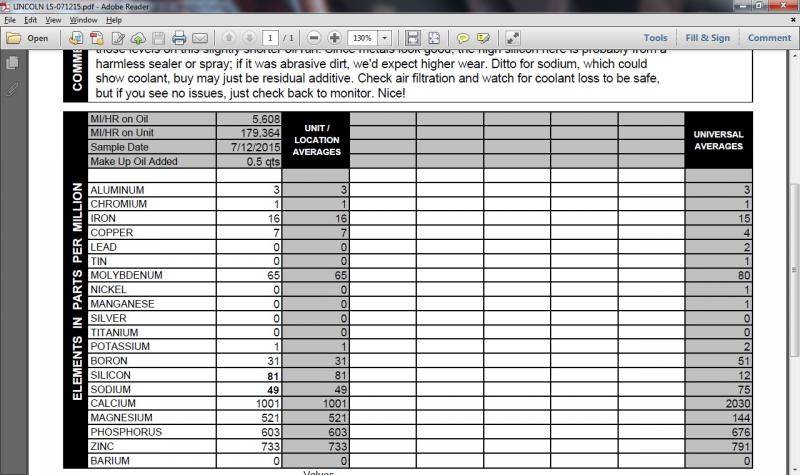

Got my Blackstone labs oil analysis back.
I've only had my Lincoln for the last 20k miles. It's had the rattle since I purchased it.
Any suggestions on silicon, copper and iron?

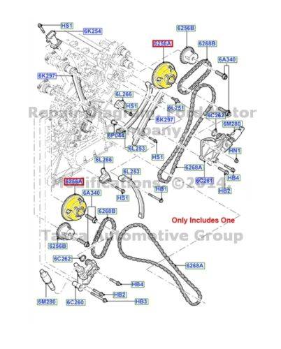

Yes, about that rattle thing...
More back on topic...[/url]
Yes, the topic of startup rattle. I have made the decision to tear the front off and do this. I already have the Christopher eBay "all chains/guides/gaskets" kit from when I though it was tensioner related. Looking to buy the "VCT Units" as listed in the shop manuals. the part number is 6M288 but I couldn't find that number anywhere on the web. Went to a few sites including https://www.bluespringsfordparts.com/2003-lincoln-ls-parts.html and found they use a different schematic than the manuals. Found an oddly described "intake gear from 7/17/00" which just sounded wrong with the part number 2W9Z6256AA. Hmmm. Why wasn't that number in the 3 part user un-friendly Ford shop manual??? Using that number found Tasca listing on FleaBay that sounds better, uses the shop manual diagram and has the proper description.
Gonna buy two of these tonight. http://www.ebay.com/itm/NEW-OEM-CAM...-V8-/281779143677?hash=item419b5883fd&vxp=mtr
Oh yeah also need to rent this tool kit, standard is you get it for a few weeks.
http://www.ebay.com/itm/LINCOLN-LS-3-9V8-TIMING-ALIGHMENT-TOOL-SET-2000-2006-/370369431909?
