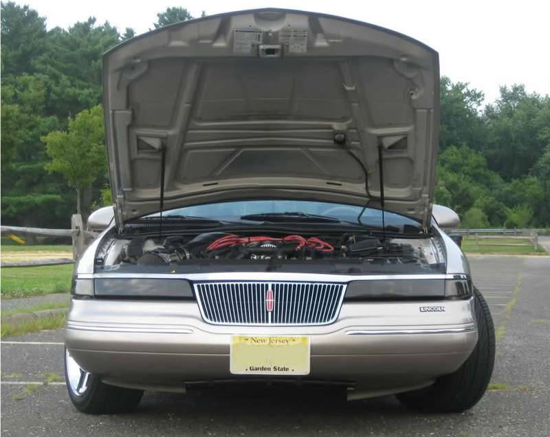

I personally like the vinyl wrapping but its a pain to do sometimes. Got to have the patience to do it. I wrapped my headlights with it and it looks amazing.
I wrapped my front grille as an experiment, pain of the ass but came out descent for my first time.

That looks Sweeet! Did you heat shrink the vinyl onto the headlights? the Vinyl have is supposed to be for show , its like a Stick it on and you can peel it off and its reusable which I am not too crazy about.
This is also the stick on stuff but you have to wet the sticky side with soapy water and position it on the light. Then I took a blow dryer and formed it to the light. The blow dryer dries out the soapy water. You will probably have some small air bubbles but the sun light will eventually get rid of them. I got my vinyl off eBay. I think the seller is xspin.
