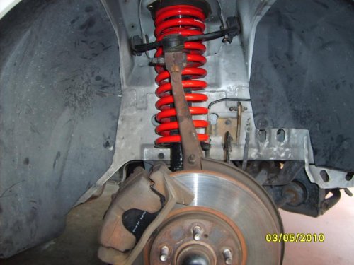

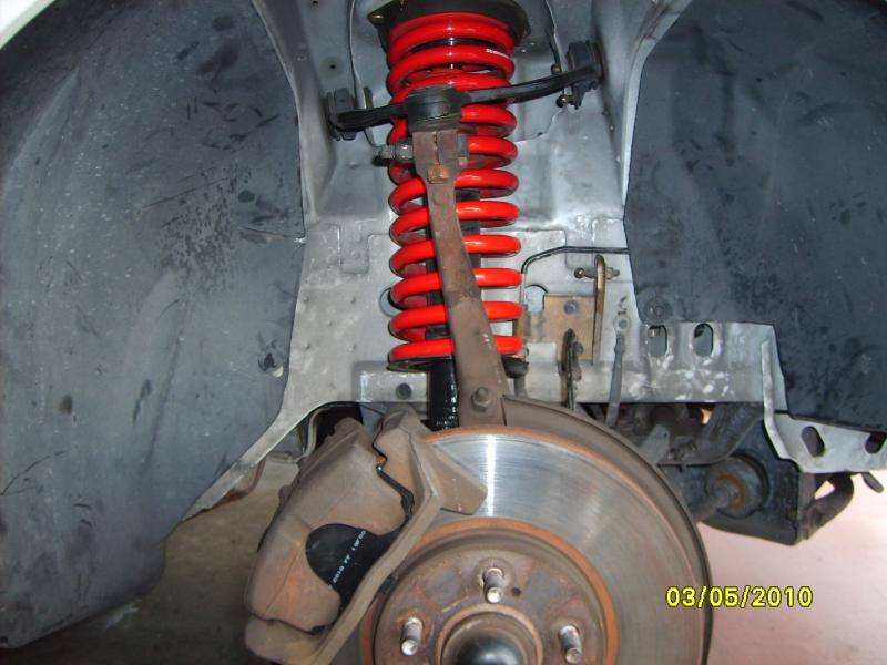

Well I took the coil conversion and put it on my Mark. I did not cut wires or toss anything as it is a trial period with this. If I do not like it I will go back to my air ride and sell the kit. We will soon see, pretty simple though, took about 3 hrs for the first time. I heard about some saying in previous threads about the stock Motorcraft Air ride shocks were not idea for the coil conversion, so I bought some new Thunderbird Monroe SenaTrac for the rear.

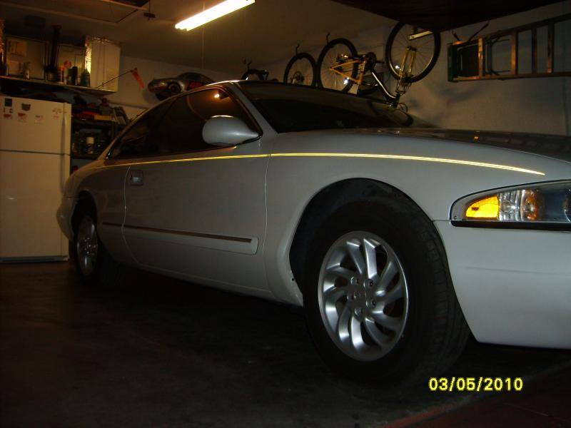

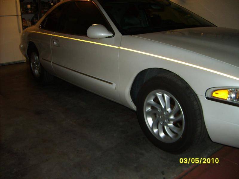

The cool thing is after install, the wheel well height is that of the same when I sensored lowered it last week, right at 27.5 inches. It still could be lowered maybe another inch, I thought it would put it at stock height. So I do not know if this is a lowered kit or not. But I was happy. I took it for a spin after and around the s-turns around my neighborhood. Drove pretty good and under control. Did not witness any sea duty with leaning or turning, pretty stable and stiff. I will wait and see.
Nothing wrong with either system. If you have air and it works, great, if you fix it, great. If you want springs, that's good too. Glad all went smoothly.
Thanks, I will ride on it till next weekend and see how I like it. For $80.00 for the kit, and $75.00 for the shocks and $15.00 for the sway bar bushings and 3 hrs of my time, not too bad if I say so. If I do stay with it, then I will clip the wire behind the P/S kick panel to delete the air ride warning.

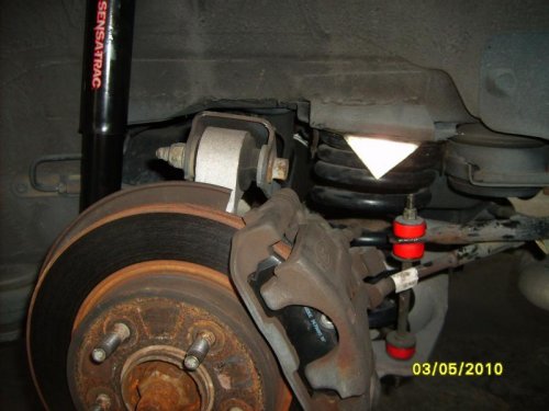

Are you talking about the SensaTracs or the air bags being the same? I did leave the SensaTracs on with the air bags, found no difference with the SensaTracs vs the stockers, at least as of today, may find a difference in a few days though because of dampening of the shock, but it seems just fine though.

Yes, I have SensaTracs and that dampening thing really turned into being something it wasn't. 93's and early early 94's had them and then they stopped putting them on. Mine just had bad bushings and was annoying the hell out of me. By the time I got down the road to the store or anywhere, I was pissed off from listening to that noise. I put them on a while back and they are still doing good. Nice and quiet.
