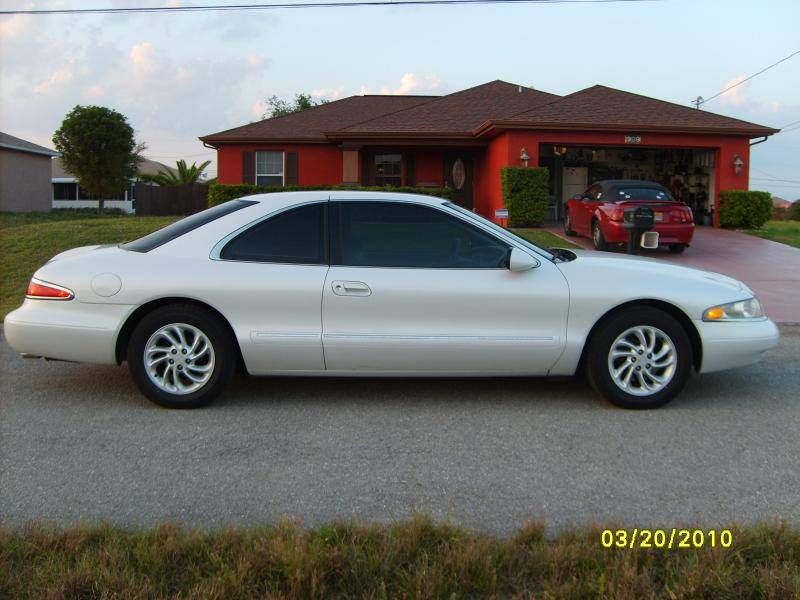

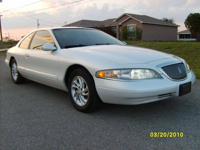

Well here is a daylight stance pic with the final conversion, sits nice and lower than stock.
