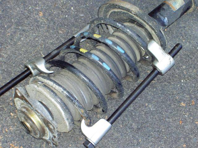

I don't think that style of spring compressor will work. I bought some that looked like this.
Air tools will save you a lot of time.
+1 that's a coil spring compressor. you need a strut spring compressor.
and
+1. an impact wrench saved a ton of time.
that's how we did it on a taurus.
not hard but you need to be careful. those springs under compression are a bomb.

I got in a pickle and couldn't do the rear stocks my self. Sears charged me ~$60 per corner to install. So, at Sears you're looking at ~$250 labour plus the price of the shocks. It's not too terribly difficult; just make sure you mark the location of one of the bolts and use a QUALITY spring compressor.
Thanks for the quick responses! I assumed since we had shocks not struts I would need a coil spring compressor. I do have an impact gun and it was the best investment I have ever bought! is it as simple as the tech article looks? just the four top bolts and the LCA bolt?
Still at 260 + the shocks that's still less than the 1100 they quoted me lol
Yep. Its that simple.
+1 on the quality spring compressor. I bought a cheap one and messed up the thread on it. I rented one from autozone, its was better built than the one I bought and it worked great and super easy.

Installed new motorcraft shocks and eibachs the other day and everything went smoothly.
Did everything with hand tools so it took awhile to do.
Rented a spring compressor from autozone for 58 bucks.
Easy as pie.

Yeah definitely not 1.2h per corner.. They take 30 min to take off tops, with manual tools.
For a bit more money you can buy new complete assemblies with the coils and shocks together...then it is just a bolt-in affair.
You should mark which stud goes where in the shock tower so there is no confusion putting it back together. Use a white grease pen or anything that will not come off during removal.
+1 on just renting the spring compressor from autozone. Air tools will cut out some time but most of the time is spent wriggling the old assembly out and the new one in. Spray everything down with the PB Blaster the day before.

You can do the whole thing yourself. It only took me about 3-4 hours for the fronts. That's with me taking a trip to the shop to use the spring compressor.
I bought the spring compressor tool from Autozone and do not recommend using it. It's doesn't sit right on the spring......very dangerous. Last thing you want is a loaded spring to get loose in front of your face.
