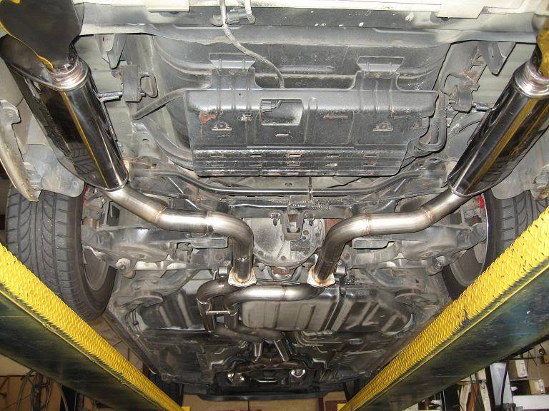

The rear hangers are easy, as they bolt on, so you should be able to get those from someone who's parting a car, if they're gone.
The center cross rod bolts to the trans mount, so it shouldn't be a problem.
The only other hanger in the system is welded to the rear sub-frame above the inner LCA mounts.
Holes can be fixed, crappy welding might have to be redone.
Hard to really understand how bad it is without pics. Wish I was closer, I'm sure we could fix it.

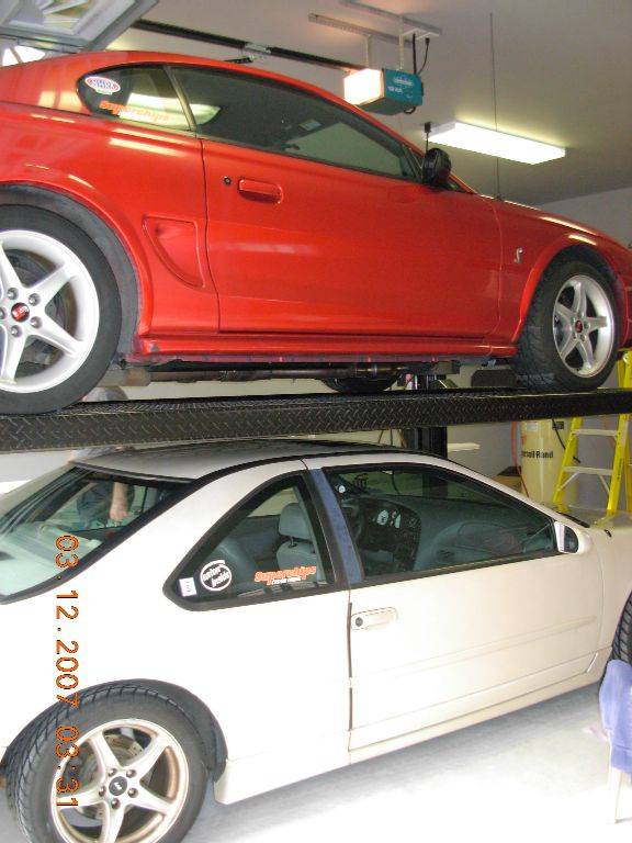

You sir have my dream garage. I pray that someday I own a home with a garage like yours, car lift & all... That's the type of home a Mark VIII deserves :D
Thanks!
But the LSC has to share. ;)

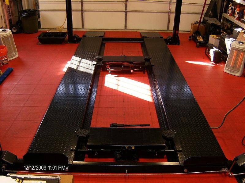

I actually picked the 4-Post lift over the 2-post for a couple of reasons.
1. I needed to be able to do chassis work, particularily on my Cobra, with the wheels weighted.
2. With the two sliding hydraulic jacks I also have, I can raise an entire car, and remove all four wheels if needed.
The one downside is that I can't drop an Engine/K-Member combo out the bottom. :(
p.s. I can also park two of my cars in the garage at the same time. :)

i have both types at work drive on's are nice but they can be in the way alot. still better than what i got i aint even got a garage
I don't really like 4 post lifts... but any lift is far far far better than no lift...

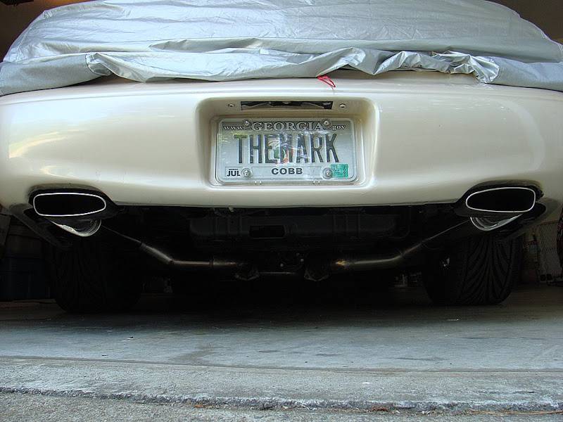

My Buddy Bryan did my exhaust. Best custom SS mandrel work I have seen on a Mark, and I am not just saying that because it is on my car lol. :) His work speaks for itself. He works out of a shop here in GA.
High Tech Transmission and Muffler 770.428.7474
1200 South Cobb Dr. Marietta Ga 30060
What tips are you running?
