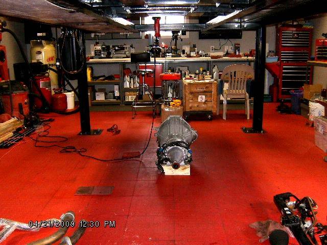

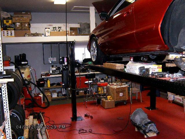

Not a shop, just my back garage (that I also built myself ;) ).

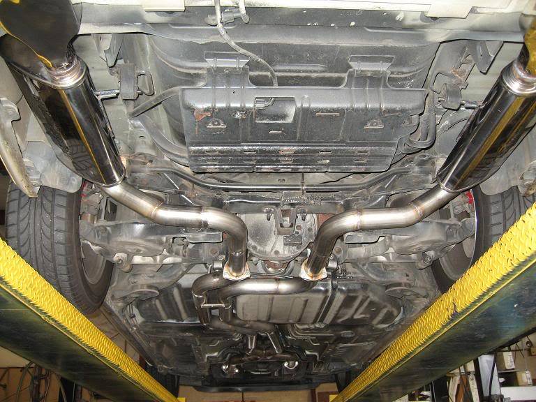

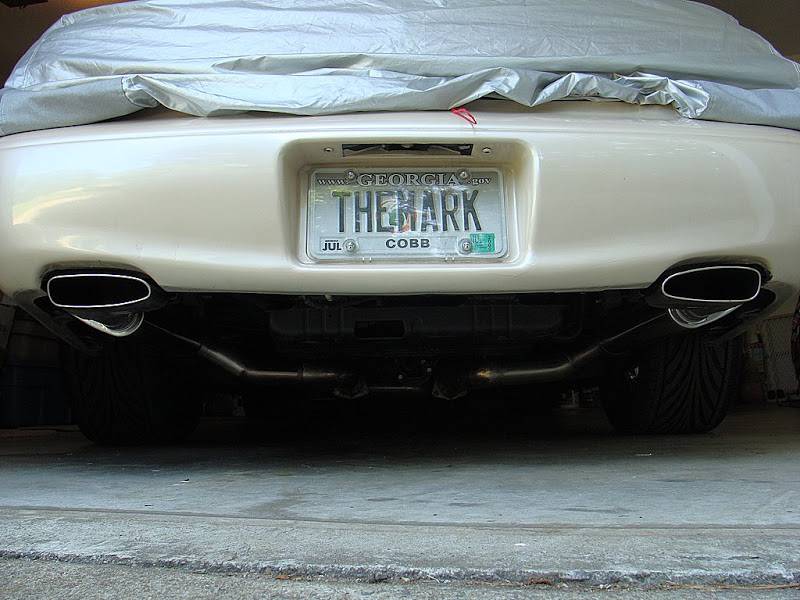

My Buddy Bryan did my exhaust. Best custom SS mandrel work I have seen on a Mark, and I am not just saying that because it is on my car lol. :) His work speaks for itself. He works out of a shop here in GA.
High Tech Transmission and Muffler 770.428.7474
1200 South Cobb Dr. Marietta Ga 30060

i have kooks headers also, with 2 high flow magnaflow cats, a bassani X and 2.5 mandrel bent pipes into magnaflow mufflers. mine is quiet at idle and cruising normally, like DLF if driving normally you can tell it has exhaust, but nearly no drone inside, but if you get on it, WOW lol instant boner!! soon as i get it on the lift i'll take pics.
