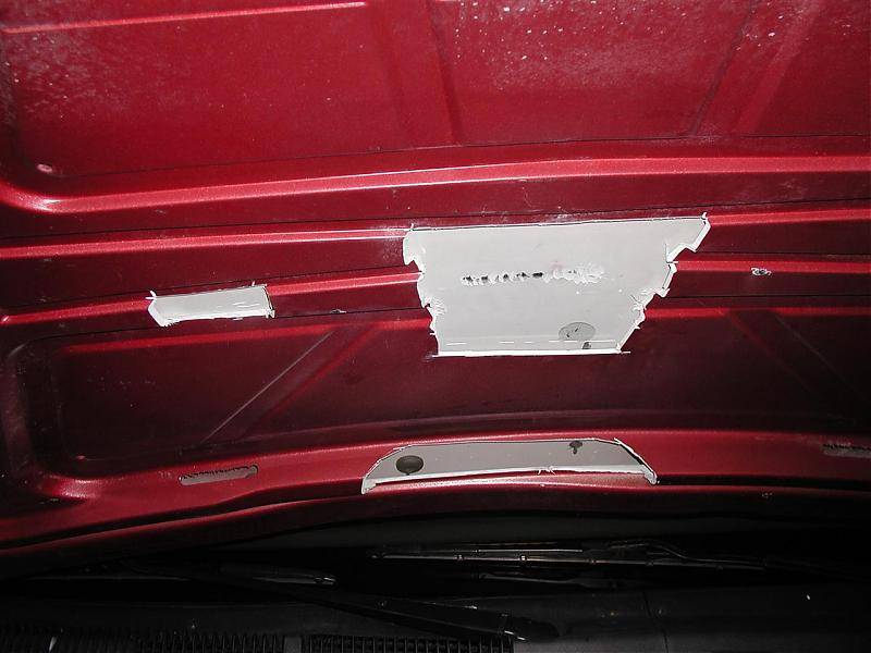

I know a lot of gen2 guys run cobra intakes with no clearance issues but I havent seen any gen1s with cobra intakes under stock hoods. Has anybody done a cobra intake on a gen1 with a stock hood?
Here man.
These pics were taken by Jeremi on his/my old 95.
This was also with 1/2" spacers on the K member. If I were you, I would use the spacers AND have the fins on the upper intake hat milled down flush.
Mike
as far as i know it won't fit under a gen 1. My buddy bought a 95 from a guy who cut the crossbracing to clearance the cobra intake, but the fiberglass hood ended up cracking out because there was to much flex.
well, mike was the guy i was talking about and there you go! lol we posted at the same time.
Don't do it. It will not fit. I was led to believe by several people back in 2000 that with minor mods it will fit, but at the end of the day we had to cut up the hood to be able to drive it home, and suffice to say it looked and function like :q:q:q:q. Milling the intake + spacers, and then reinforcing the cut out parts (you still have to cut the back support even if you mill it) is the only way, other than a funky hood ;)
