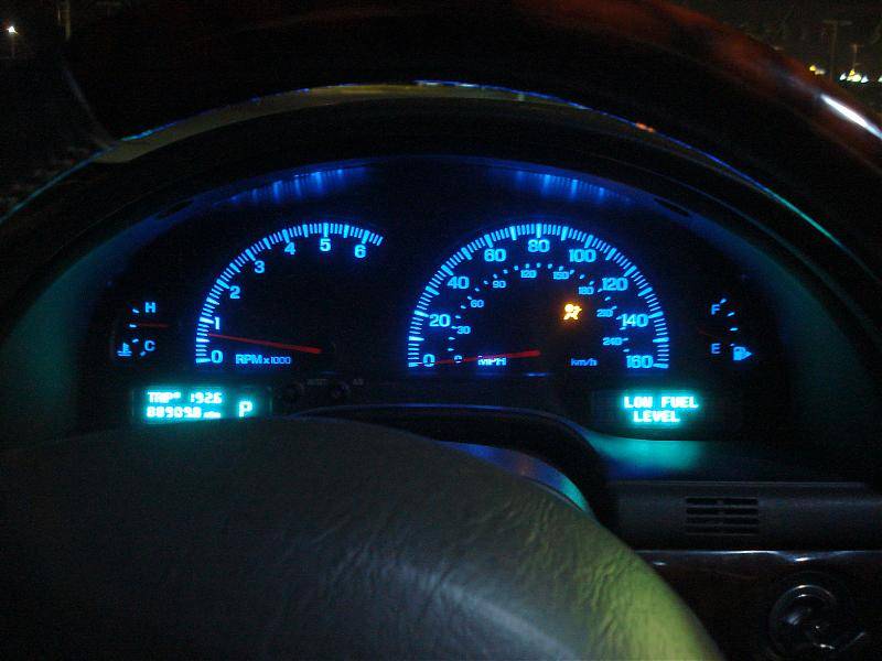

Im going to post a pic of my instrument cluster... . so far its the only pic I have.... the instrument cluster does NOT use the surface mount led's but the heater controls do... havent got those in yet.... everything else uses standard led's... but with a voltage of 2.6 to 3.2 volts.... got that part solved tho....
as foor the instrument cluster... well... the needles show up just fine... the hard part is getting them back on just right... cause u have to remove them so that you can take the instrument cluster "sheet" with the numbers n stuff on it and sand the back side of it with sandpaper....

That is AWESOME! I want! Now if only we can find a color screen for the message center and odometer...
What are you sanding off of the plastic sheet? Is the green color the lights or a coating on that sheet?

several of the lights can just be replaced with blue led bulbs.... but the intrument cluster "sheet" is coated with the green coloring.... it has to be sanded off... this is the case with a few other things in the car.... and if you sand too much... you ruin the actual numbers or picture.... trust me i found out the hard way..... the gear selector switch is actually 1 solid peice of plastic with the green color inside of it... so just changing the bulb does not work, I am actually in the process of making a new one from a mold of my oold one.....
