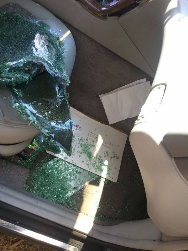

Walking back to my car after class my friend (who carpools with me) and I saw a guy sitting in the car. He climbed out and we apprehended him. The lady across the street from where I parked my car had called the cops and the cop was in her house at the time. He walked out and arrested the guy.
Anyway, does anyone know of a walkthrough on how to replace the window? I'm going to the junk-yard soon.

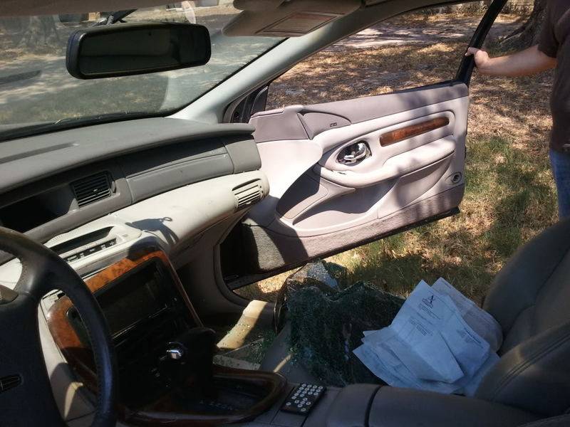

Which window? Door?
It's the passenger side window. Looks like the clips are riveted in place though and the windows are glued into the clips.
I'm getting a window from greg later tonight but I need to take it out of the car. I'm figuring I'll just drill out the rivets.
Any ideas on that?
We each had one of his arms behind his back pretty firmly. He wasn't feeling too well.
the arm holding the window seems to be riveted also to the window motor.
Not sure what you mean by 'glass bolts"
There should be bolts that bolt to the clips on the glass that sit in window regulator track, but i could be wrong...if there riveted to window regulator have fun

Before you install the new doorglass, be sure to vacuum ALL the glass crumbs out of the door, at the glass shop where I work we have an attachment we made out of a piece of flexible half inch water line, lets ya get down into all the nooks and crannies. Above all, make sure that the fuzzy channel that the window slides in has absolutely no glass in it, be thorough. Just one of those little rhinestones will scratch the crap outta the new doorglass, and can even break it.

I just got back from greg's (GMAN) house. He gave me a new bezel and a new passenger side window.
The windows are freaking riveted in there... had to drill them out.

window is already fixed. Need to put the door on and bezel and everything will be back to normal (except the tint and the scratch.)
