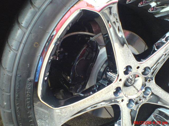

Jamie, your rotors look like they have been way over heated. Also the wear marks are unusual. Does the car have a bad wheel bearing or are the rotors loose?
the rear rotors are :q:q:q:qed! jeremi sent me a set of rings to get the rotors centered and true, when i hit the brakes it feels like the trunk lid is gonna rattle off the car lmfao!!

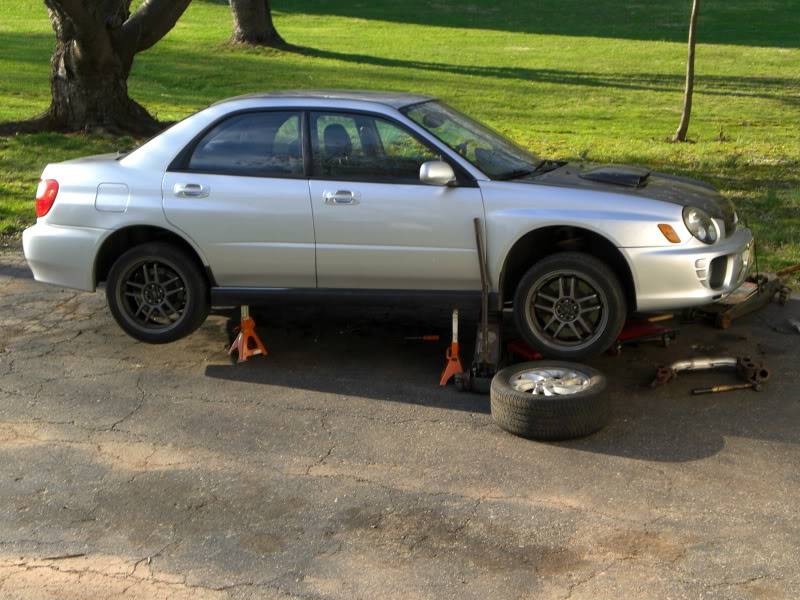

I did a big break upgrade on my WRX to 14.25" fronts and 12.75 rears. It not only made the car stop much more smoothly but made the pads last longer too :D
I went thru a lot of pads and rotors when it was stock sized but since I switched I still have the same big rotors and all this with the stock calipers to boot. I would do that with my Mark in a sec if it didn't mean I had to go bigger rims right now. Funds are tight and the stock rims are holding the semi snow tires so gotta stay small for now :(
